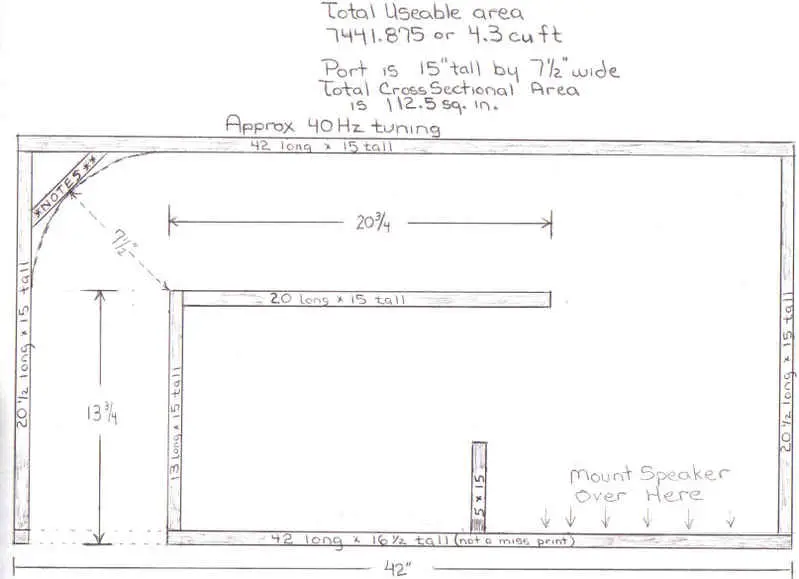

The max width is 42", Height I would like to keep under 16", and for the depth it would be nice if it was under 12" but that means that unlike the other members box the sub(s) would have to be mounted on the vertical face...not sure if that means you can't do it or what...
that is about 3.6 cu ft gross...Kinda of small but I'll see if I can make something fit.
What enclosure are they in now??
They are in a sealed box that is baiscally square...except the back is slanted approx 15% to match the back of my back seat...like I said it was built to be small...
Would it be possible to only do a box for one sub, with demensions similar or smaller?
There is enough room to do a nice ported enclosure for one sub.

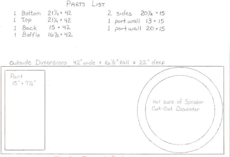

Here are the original plans

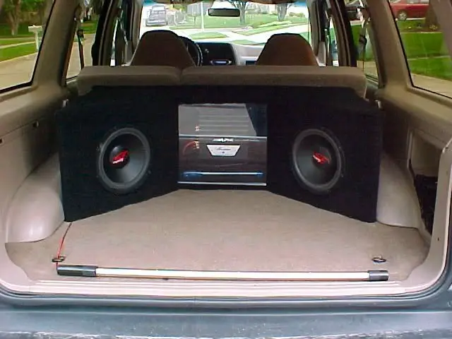

hey, im planning on making a box like justin146 showed in the pics of sub boxs topic ( http://www.explorerforum.com/forums/attachment.php?attachmentid=29542&stc=1&d=1134359065 ) except with only two 10's instead of four. I still want it to go the with of the car bu just have like two storage area type things were ill put the amp on one side and idk what on the other. the height would be like 15.5" and would want depth to be a small as would work with the 10's. So i pretty much would like to know what the best dimensions for a box for two 10's mounted on the top of the box with a height of 16". I drew a really crappy picture of what i plan if it helps at all.
thanks for any help
-Matt
