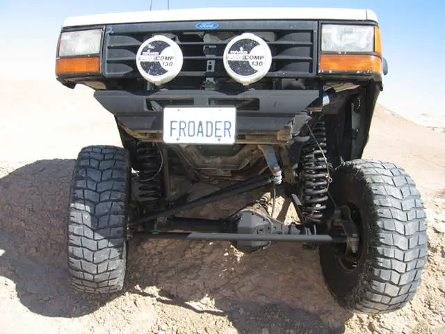

My buddy Winter has some skills when it comes to fab, so I had him help me out with my idea for a bumper/winch mount. The weather wasn't the best at the beginning of the day, so we used an EZ-up to keep any mist or drizzle off of us while fabing. As the weather got better the EZ-up became the shade for the work area.
I told Winter I wanted the winch as far up and back as possible. This is what we came up with.
Tools used were a hacksaw, hammer and J-B Weld..... :p:
Me grinding the frame clean.
Winter tacking the plate in place.
Finished all of the fab at the shop, and Winter had dinner plans. I got home a finished painting the bumper, mounting and wiring the winch and cutting up the grill.
YOU KNOW IT!!!
With the grill cut up to fit, and the license plate holder I made out of Mag Light mounts.
Eventually I'll get some gussets on the "stinger" and bars to protect the headlights/turn signals and some light tabs. But for now, I'm loving how this came out.
Since I repainted the grill the light bezels look horrible, so those will be painted tomorrow.
The rest of the pics are here, although I didn't leave much out of this thread. :)

That looks awesome Colin, so what do you have in mind for the lights protection? And is just that center section enough to be legal for street driving? I've always wondered about the guidelines for custom bumpers.

It's 100 precent legal, California has no special laws pertaining to bumpers aslong as it does'nt obstruct driver view of the road.
Practically anything can be used including a 2x4 chicken wired to the frame is legal from what the Cop told me awhile back:p:
But that bumper is awesome looking. Nice Clean and simple:thumbsup:

Hey Colin do you see any need to protect those headlights? I mean I know it would be quite a drop off to hit them on something. Your bumper keeps the sick approach angle, but are you going to add anything to it?

Matt, I've had my front bumper like this on the last 2 explorer for ~9 years combined so, it should be ok.
Matt and Jamie, I'll eventually make the side bars similar to IZwack's. Just a single bar running from the sides of the frame up under the lights and a slight bend around.

how much will that affect the cooling? looks sic

Nice looking! The bracketry/plating that attaches to the tube to the chassis is super clean.
And you cleaned up that winch pretty good since you received it.

minimal coolig afecting, and froater that is what i wish mine looked like, awesome desgin dude, did you arc or mig that bad boy
I thought maybe the fact it was still the stock bumper had something to do with it. But thanks for clearing it up.
