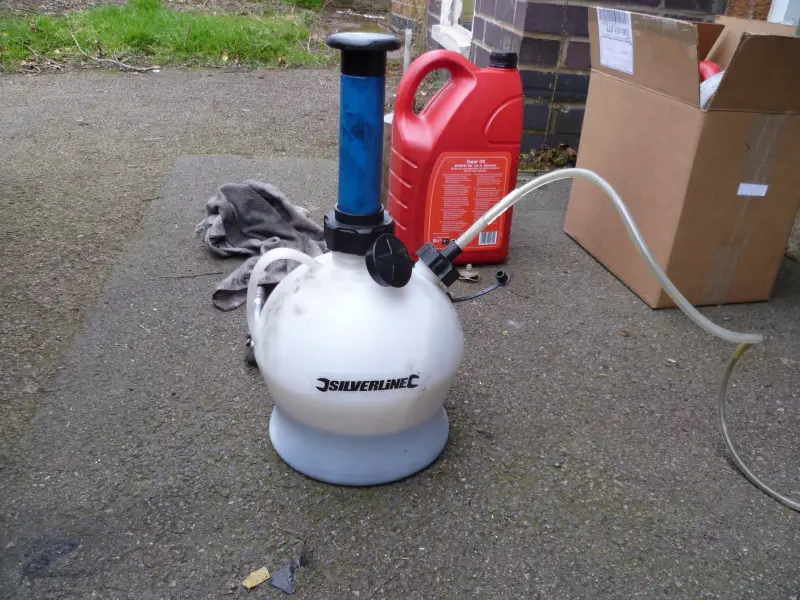

A couple of weeks ago I got the gear oil and was going to do it but then I discovered there is no drain plug . I could have sworn last time i checked there was one but hey. Got on ebay and got a oil transfer pump for £20.50.
Now earlier in the week I tested the pump to make sure I could get the tranny fluid out to save getting a mercon shower when i drop the pan again. It worked for about 10 secs before the pump plunger failed. The seller wasn't very helpful so I dismantled it and found an oring had slipped out of a groove so I wedged it back and put a spot of vaseline on the tube and hey presto, all good.

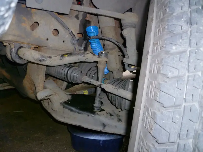

The filler plug came out ok (use the square of a 3/8th drive) and pleasingly a small amount of fluid dribbled out, that is until i saw its state.
In went the tube and vacuum applied, out the fluid came.
It took about 20 mins to suck it out with regular pumping to keep the vacuum.

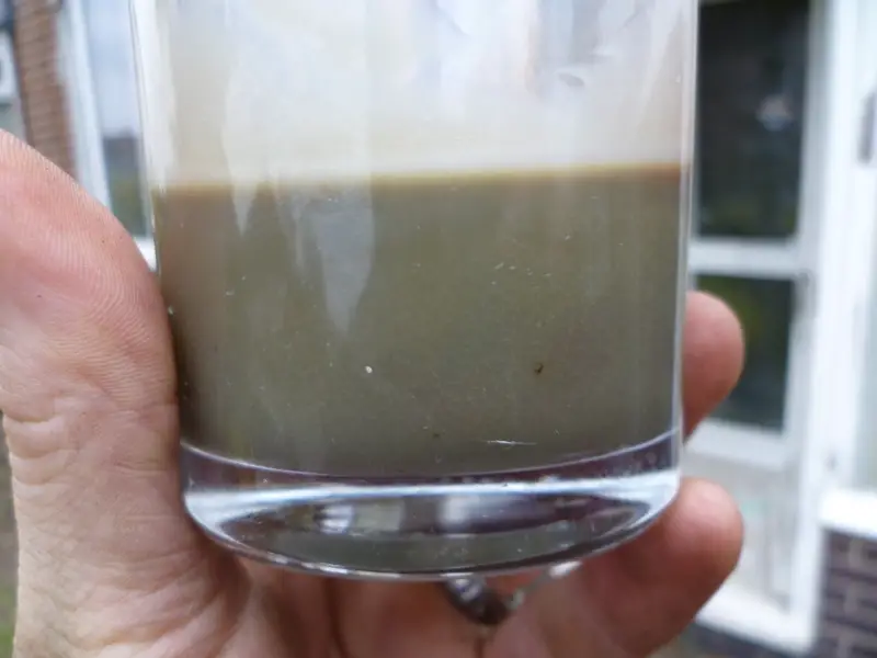

And check out the state of it
Because of the state of the fluid i'm gonna redo this in a couple of weeks or so to get as much of the gloop out. I bought 5 ltrs of the oil as i could get that cheaper than two 1Ltr bottles
