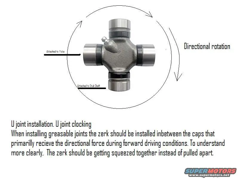

The grease fitting is clocked in a certain position in order to keep the balance and strength ....
True, but you should avoid buying a joint with a zerk fitting. Get the stronger choice without them, they generally last plenty long enough.
eBay is the best deal to buy the strong u-joint, Summit has it there now for the best price.
I didn't use a greasable one - for strength reasons. I don't go in mud/water, at least not to the shaft height.
OE is not greasable either, so the shaft is balanced without zerk fitting.
What joints do you use ??
I'm not very particular, so Moog comes to mind. I just looked again and noticed that the one I was watching from Summit does have a zerk fitting showing. I'd use it for an application like street or mild off road use.

If you would submerge the joint a lot, and would regularly grease every fitting, the zerk fitting parts are usually fine. If a truck was breaking a certain part that had a zerk fitting, then that one part at least should not have a zerk fitting.
For really hard stress like serious off road duty, find one without the fitting. They tend to be sealed very well and don't let the grease out easily.
