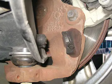

Does the "popping" occur when the steering is turned to full lock and the tires are going over a curb? If so, could be
dry steering stops on the lower control arms and spindles. Pic below is of a ST, but should be similar to your Gen 3.
Apply heavy waterproof grease to BOTH contact points on each LCA and knuckle.
Steering stop "nubs" next to lower ball joints.
http://www.rockauto.com/en/moreinfo.php?pk=1328771&cc=1427767&jsn=50 (First image)
http://www.rockauto.com/en/moreinfo.php?pk=1328739&cc=1427767&jsn=49 (Second image)

It actually happens when the steering is completely straight and about a second or two after going straight backwards. Never have noticed it going forwards.

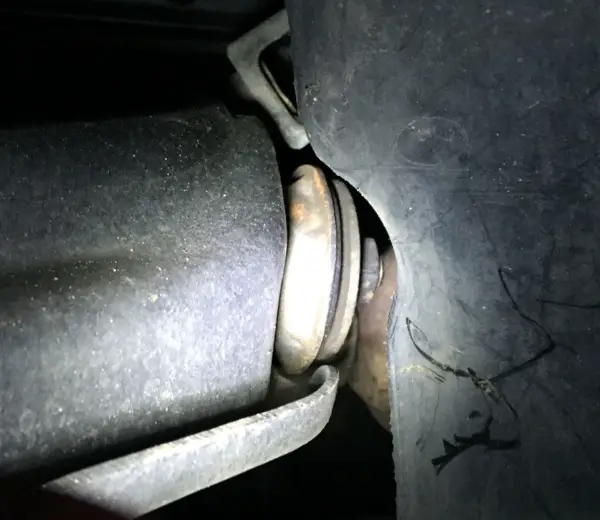

Reach up to the outer sides of the bushings I spoke of. There's a large washer on the outside of the bushings, locked in place with a crush nut.
1. See if the washers spin. They shouldn't.
2. See if the nuts have backed off. They may be movable with your fingers. They and the washers, may not be there anymore also.
I know I have tightened these at least once since installing them. I remember one side being loose. Should I just tighten them as tight as possible? And do you happen to know what mm wrench?

I don't recall the wrench size. You really need to warranty them out, the nuts aren't supposed to be reused. Then, before installing the new ones, put some green Loctite on the threads. It should seep in and prevent the nuts from coming off.
You could attempt this with your current controls arms, it's just easier when you can set them on end.
