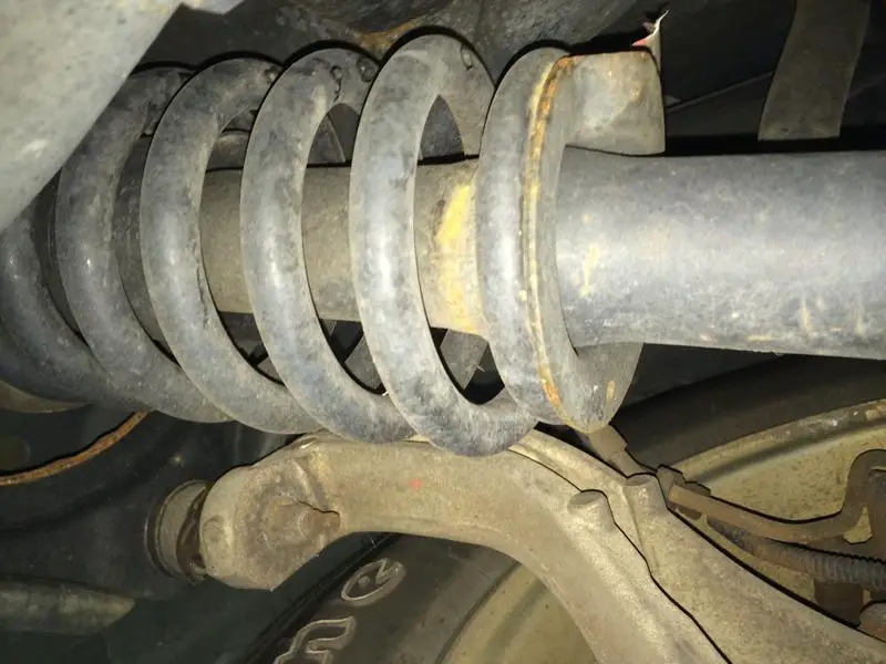

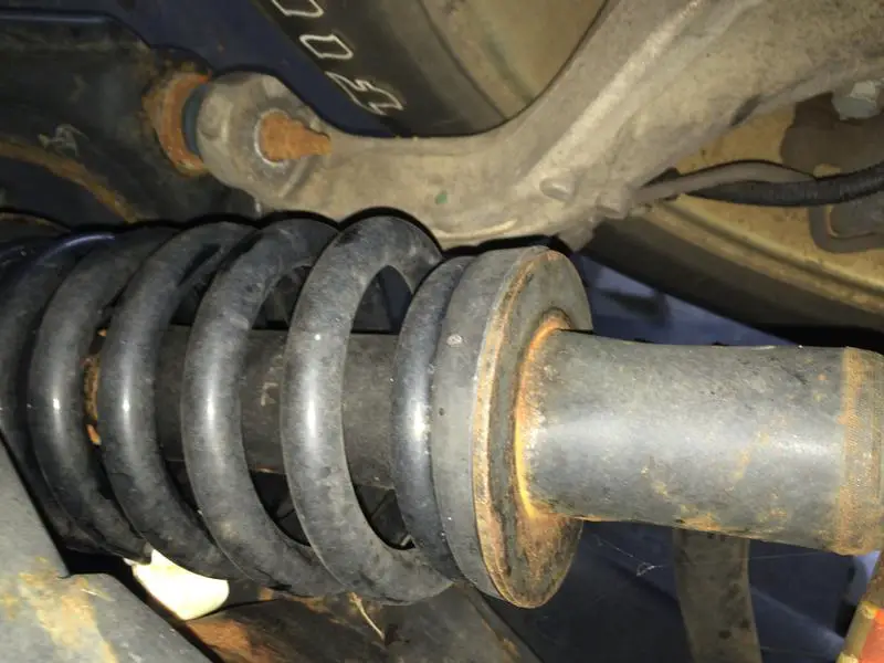

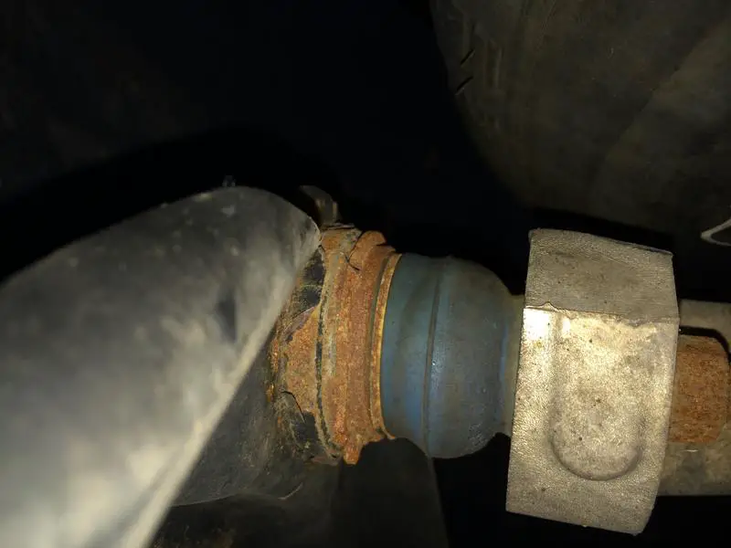

While driving yesterday, i noticed this squeak when going over bumps. So, I crawled under and found a ripped ball joint. I'm guess this is what is causing the problem?
I attached pics of ball joints and struts.

Yes, that ball joint grease shroud is toast in the 2nd pic, so that joint has probably lost most or all of it's grease. The one in the 1st pic looks fine from that photo angle. You can test the movement within the ball joint with a pry bar to see if that joint is bad by now. Just type a question into the search bar at the top of the forum for past posts on "how to check for a bad ball joint in your generation Explorer". You'll also find posts on how to repair the upper ball joints as well and what tools you will need. As far as the squeaking noise you hear, bad ball joints usually make some kind of "thud" sound going over a bump, not a squeak to my experience with them. The squeak noise could be coming from old, but working struts and according to my mechanic who told me it is normal for 3rd gen Explorers to have squeaky, but still usuable good struts. A strut goes bad when they leak hydraulic fluid from them and the one in your pic looks dry, so I'd say it is still working okay. Your squeak issue could be coming from dried out "sway bar bushings" which is very common on these Explorers. I just changed my sway bar bushings 2 weeks ago, very simple job to do as long as the bracket bolts will loosen up. There are posts in here for that job as well. Hope this helps.
I would bet that the squeak you describe is from the sway bar bushings.
That said, your ball joints aren't looking good, but as the previous poster said, they usually don't squeak - more of a thunk or clunk.

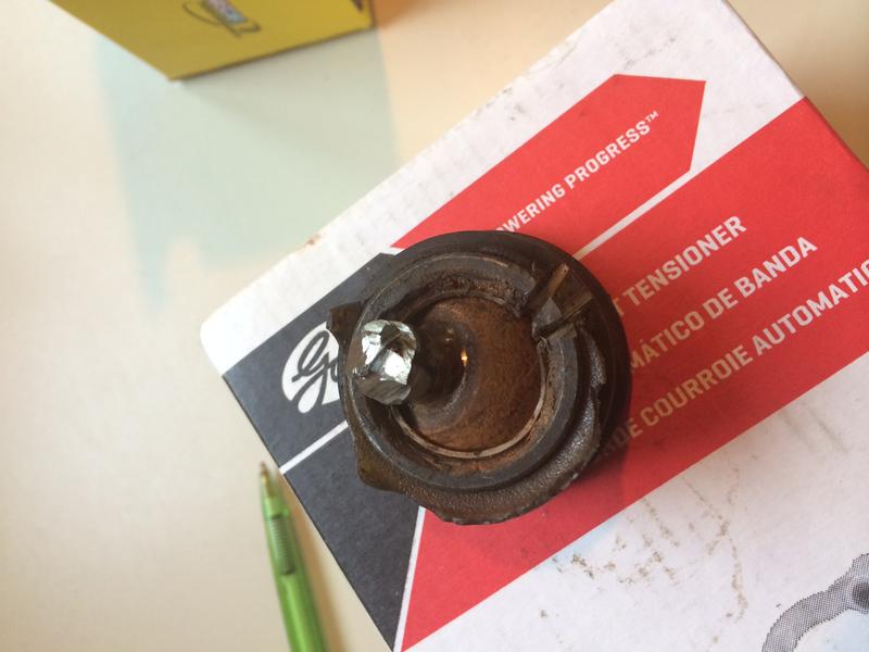

Got the ball joint replaced, and that seems to have taken out a lot of the noise. Some creaking remains but I think thats the struts. With the new Monroe promo, i'll order 4 of those.
