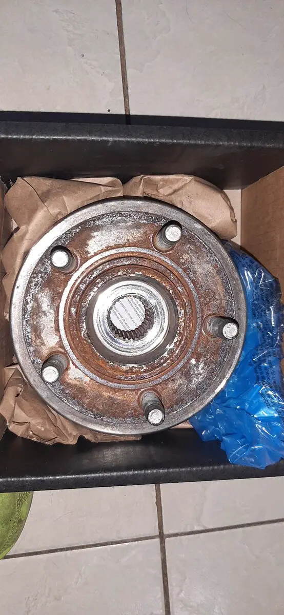

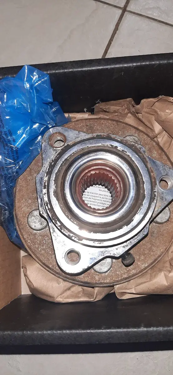

Hub29 - the oem spec one.Fomoco hub body casting.Timken bearing.made in USA
Hub6- cheaper service (aka low cost manufacturer approved aftermarket part) part.noname bearing brand.made in China.
Both are front Motorcraft made hubs.
Failed Motorcraft "service" front hub.chinese made with noname components.total junk
