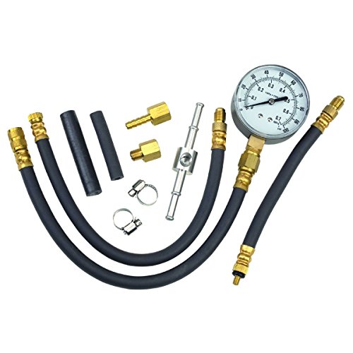

So - If you have a HF close by - a fuel injection pressure tester might be worth buying for $20. It hooks up to the Schrader valve on the fuel rail.
The coupon below brings it down to $16
Link: http://www.harborfreight.com/fuel-injection-pump-tester-92699.html
Coupon good thru June:

Get the fuel pressure tested. On the return-type fuel system it should be around 35 PSI at the rail. On the later return-less style fuel system you should have around 65 PSI at the rail. If your fuel pressure is low and your fuel filter is new it's probably the pump that is bad, but there are instances where you may have a split hose between the pump and the FPR in the tank or a bad FPR, but it's usually the fuel pump that goes bad. I think it's probably a good PM item to replace the fuel pump at around 150,000 miles. They just wear out.
