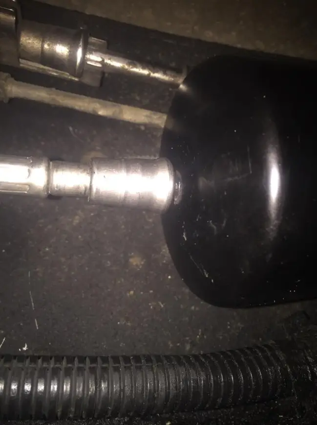

So.... I go to change my fuel filter.. Easy enough, right?
WRONG.
This is what my filter line looks like....
So....
How the heck, right?
I got one of those "special removal tools" to make it easy...
The freakin' tool doesn't fit between the filter and the push lock thing..
So I cut it down hoping it would work (albeit cut very jaggedly...)...........
Ugh, this is the result.. NOT EVEN CLOSE.
Maybe I'm a freakin' moron but I reckon my filter lines are... unique...
Someone please tell me how to change this fuel filter... this is just one of the 500 different problems with my truck right now and I am running out of patience for everything to have a little gimmick to it.. :/
THANK YOU.

But look at my picture and how the plastic one doesn't fit at all even after being cut down 75% in size with a razor...
After being cut that much, it probably wouldn't even reach in there far enough to get to the teeth anyway!
Get what I'm saying?
That's as far away as the filter will get from the line fitting itself..
I can barely fit a quarter in there!

But the teeth of the metal one (and the plastic one) are thicker than the width of 2 quarters, and really that is the most that can go in there is the width of 2 quarters as you can see in the picture :/
Do you think I'll have to snip the filter nipple?

Since the fuel line has been replaced with stainless braid hose and no clearance, I would cut the filter nipple with a hack saw. Stainless filter should not spark. Once the other line is removed you should have plenty of room to insert any disconnect tool.

Someone said this would happen if they put a ranger filter on an explorer? The nipples would be shorter?
What about wire snippers? Ugh.

Ahh, yes, the ford quick connect. Typical of ford to design something that can be put together fine, but impossible to take apart. My advice is to get a tin snips and cut the filter off. Worst case scenario, you have to buy some new high pressure fuel line, and put it in.

That doesn't look like the right fuel filter that someone stuck on there. The neck on the filters is supposed to be longer in order to give you the clearance to get the tool in there.
It looks like you're going to have to hacksaw the neck/nipples off the hose. Cut as close to the fuel filter as you can. Once it's off, use some pliers to crush the diameter of the neck/nipple so you can get the tool on and pull the neck/nipple out of the hose fitting.

There is a filter with long nipples and one with short nipples. Explorers take long nipples and yours has the short nipple filter. Cut the nipples off the filter and then the tool will fit so you can pull them out. Its the only way man.

Hey guys! At least finally a good update. Cut it off with a hacksaw and it all went pretty smoothly. I put the correct fuel filter on and that should make the next time it ever has to be replaced a breeze.
