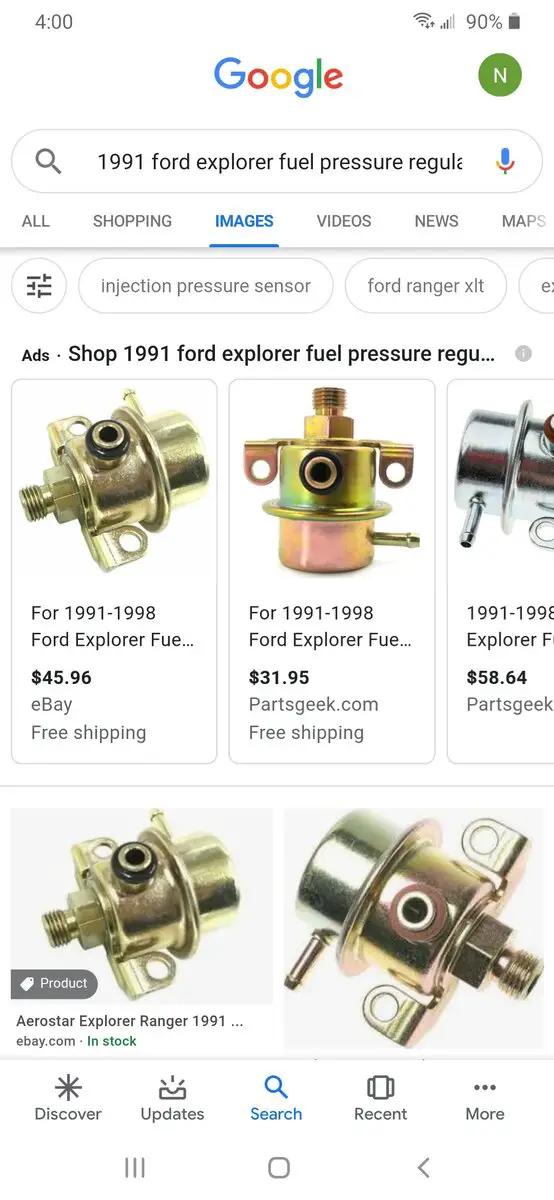

This is the part. The hole with the O ring is the 1 in question.

Doesn’t that o ring part fit into the fuel rail?

If you could post a pic of your actual FPR attached to your actual fuel rail it would help much more.

The regulator has a pressure port, return port, and a vacuum control port. The O-ring port is the pressure side port and seats in the fuel rail. It is held in there by the two mounting bolts. Is your FRP just laying loose? You're right on the other two, the thread port is the return, the smaller port obviously the vacuum.

like I said the o ring port goes into the fuel rail.
flip it around OP and let us know if that works

So yeahhhhhh....it was backwards ☺ in my defense the vacuum hose barely reached when we flipped it correctly so that's probably why it was put on incorrect. As for the schrader valve ....it's actually called a fuel pressure relief valve and I found a part number and ordered it from Ford.
