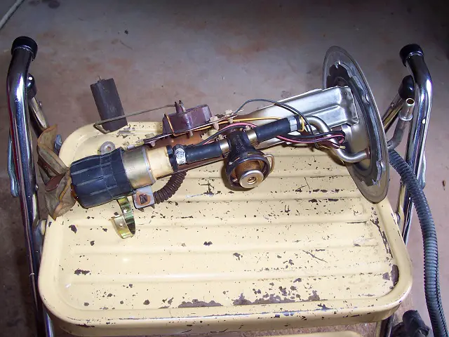

When you turn the key it does have pressure, but than the pressure goes down. ( im told it should hold the pressure)
When running, the pressure is about 10 to 15 psi too low.
That sounds like you have a split in the feeder line going
from the fuel pressure regulator to the hard line inside
the tank. Pressure is being relieved through the split hose
when the pump stops, and the split is also reducing
running pressure.
I noticed a split in my hose when installing a new pump
recently; it was where the clamp tightens on the regulator
nipple.
Be sure to replace the hose with at least SAE 30R10
hose, rated for submerged fuel use. And use F.I. clamps,
not the more common screw type. I'd replace the pump
too, since the labor is the same for both jobs.
