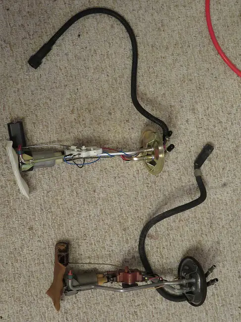

Here is a new Carter (top), and a 23 year old Motorcraft (bottom):
And here is a closer look at the float/pump/return/sock area:

I went with NAPA 2 years ago, still going strong! Whats was still going STRONG was the Motorcraft! Those Pics should be explain my story.....

The above situation is pretty much a given here in the rust belt. People might view plastic as cheap, but I have yet to see a plastic fuel pump unit break. I've replaced a number of fuel pumps, on quite a few different kind of vehicles, most of them not mine. I can't say I've ever seen an honestly bad one. They either rust out, or develop wiring problems before they get that bad. I just had a heck of a time on a 1998 chevy, after way too much time, multiple fuel pumps, I found Chevy neglected to put a ground to the frame rails of any kind (found due to high resistance from battery to frame). A new wire from battery to frame fixed all of its problems. I guess the tiny braided strap from the body to the frame was supposed to suffice.
Anyway, that Carter unit looks about the same as any other replacement. Too bad they can't use brass floats like the original. I always test the fuel level wires before installing, as I'm sure you know.

Sorry to see that mgm. That will ruin your day. At least here, the winters are not so bad (no snow here last winter) but the City and County morons salt the roads *heavily* with a forecast of flurries. As you can see, my pump was rusty on the exposed parts, but not to the point where it was holing thru.

Here's a closeup of what the top of my old Motorcraft pump looked like after 23 years. Rusty, but not holed thru like mgm's, above:
I think I may hit the new sender top with some clear before I button everything up -- to at least give it a first line of defense against corrosion. I think once I'm done, I will be able to drop the tank pretty quickly if I need to, since I'm building a simpler bracket/strap setup than what came on the truck. This time, I had a lot of work to do on that skid plate and its bracketry.
