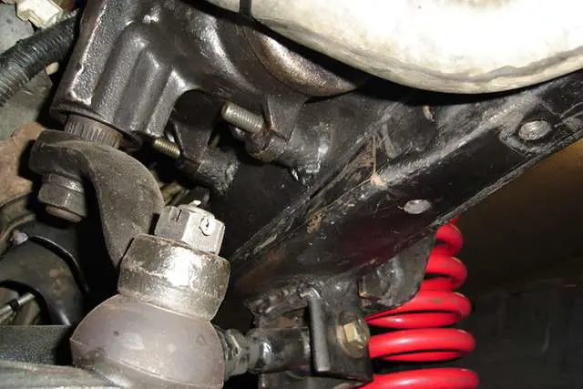

Stic-o
Elite Movie Star
September 1, 2002
14,056
1,018
Lake View Terrace, CA
'91 Navajo '99 X '19 Rngr
bad pic, but you can sort of see the C channel in between the frame and spring bucket.
