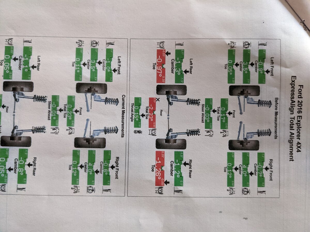

Hi everyone, I just picked up a 16 Platinum, 3.5 Ecoboost 4wd. It's got some weird things going on. It seems to wander when it hits bumps, but only at freeway speeds, usually 70+. I noticed some wear on the inside edge of the left rear tire. After following behind the car, the rear wheels seem to be angled inward, which would explain the wear on the tire. What would cause both wheels to do that? They seem to be pretty evenly angled. I'm going to get an alignment soon, but everyone around is booked until next weekend. Thanks!
