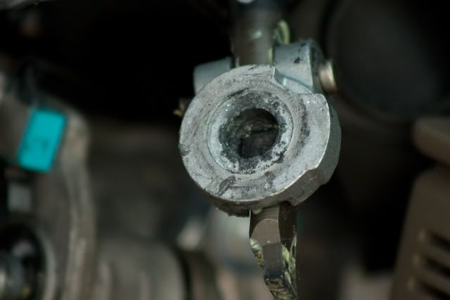

Well. Here goes. Thought somebody might be able to use this info about my experience with my wife's 2002 E.B. Explorer.
I got the call from her this morning that she just arrived at work and the gear shifter broke off in her hands. Could not get the key out so I had to haul over and trade out trucks.
Once I got it home I found that a major aluminum part had sheared off! Now, I am no expert when it comes to metal, but I do tinker with aluminum and soft metals in my garage making stuff for RC Airplanes. So, I know a little about this kind of stuff and I know that what I am looking at should have never broken, unless the batch of aluminum they used to cast the part was tainted with something or maybe an air bubble got in the cast.
But, here are the pictures that I have taken.

I have not taken pictures since I have Reattached the pieces using PB Weld. I have had great results using this stuff in the past. It is curing in the garage as I write. Hopefully, the jury rig piece will hold up to the stress of shifting the column.:confused:

I'm with you on the PB Weld, but it is a last ditch effort before I make the dreaded trip to the junk yard. I guess I'm still in shock that this piece actually broke. I have it back together and it is taking hammer blows ans so forth. I guess I'll just put it back in and cross my fingers until next time. I found the clockspring to be bad too, so I'm installing a new one.

Well, I tried putting stress on the part and it broke, as I thought it would. I guess I have to go to the junk yard and try to get an entire steering column. My day has just been made.:rolleyes:

Sidenote: Gotta but a new steering colum because the metal piece is made out of POTMETAL. Ford ain't quality anymore.:thumbdwn:

Same thing happened to me while driving my wife's 02 XLT Explorer. I called the dealer and they said 'common problem' then proceded to tell me that the only fix was to purchase the ENTIRE STEERING COLUM for $690! I told him that he must be very proud of that part and that he could keep it. Called a few wrecking yards, they want $350 for a used steering colum... Problem with the used one is that the shift tube may already be breaking. So, being a mechanical engineer, I redesigned the part and am having a couple machined out of aluminum. I have replaced all the press fit nuts and pins with screws so you can assemble it with standard tools. If it works out, I would be willing to sell the extra one for what it cost me to build, $220. Send me an email if you are interested bruced@lathropengineering.com
Just FYI, the original part is made from cast Zinc (poor design, poor material choice)

Not that I know of. Did yours break? If you look at the design of the unit you will see that it is made of pot metal. If you know someone at a machine shop, they MIGHT be able to design another one. However, the part was cast in pot metal as one unit. The design is very poor. They did not redesign it because it would not be cost effective due to the next year model coming out.
I tried JB Welding it together. The amount of pressure on that spot is tremendous. All of the pressure of the shifter is at this one point. Pot metal doesn't cut it. It should have been made of pure aluminum.:(
