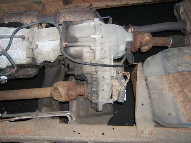

Its a 4405 from a '96 4.0l. Its exactly the same T-case you have now.

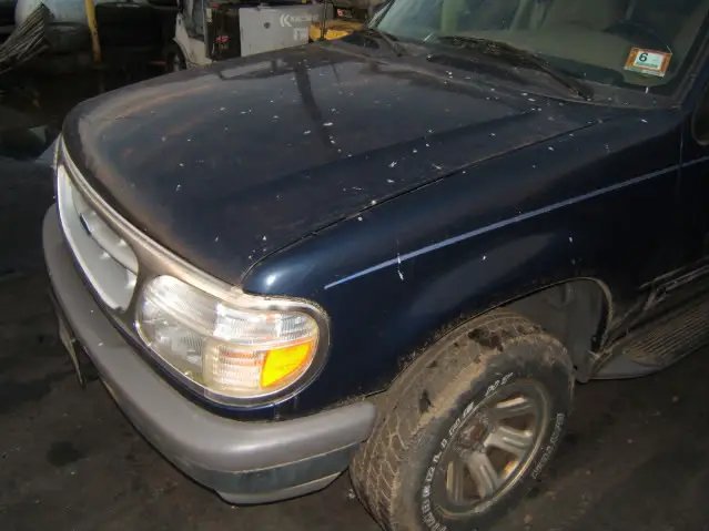

I'm working on posting some pics of the truck.
Heres some pics of the truck. As you can see the truck was taken care of. i test the 4wd, and it worked perfect. (on a side note, the truck is completely stripped now, if anyone is interested, I have every part removed and ready to be sold. I'll be posting it in the classifieds soon.)
I just ran outside and got you some pics of the T-case. It's easy without that pesky body in the way. (someone let me know if the pics work. Last time I tried, I could see the pics, but no one else could.)
