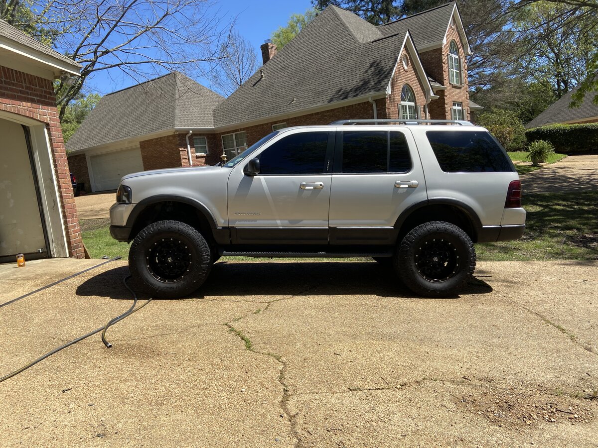

Im from Madison! I can’t wait to see this build put together! Here is my Explorer! Crazy that you aren’t too far from me. I have 6” of lift and 35s.
