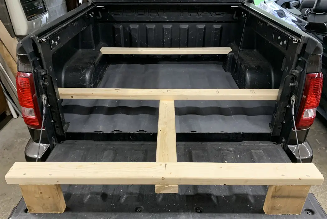

I put this together to carry 4x8 sheets in the bed. A pair of 8' 2x4's and some scrap 2x6 held together with PL Premium and screws.
It can be easily rotated back into the bed when not in use.
