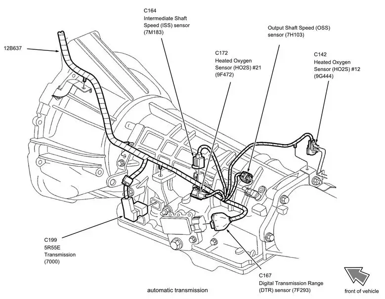

later that day (Friday night) I had a local shop pull the codes and it is displaying PO721, PO722 and PO723 and the TSS (Turbine Speed Sensor) is giving bogus reading bouncing around from 0 to 400 or so, mechanic said it should be matching the engine RPM. So Saturday morning I roll up under it looking for a loose wire or connector and attempt to find the TSS. Some have it inside the tranny and some are located around the 2:00 position if looking from the bell housing end. I found two, one just above the main wiring harness and a second a little further back both on the driver side. Did notice the soft heat or noise sheild was loose above the tranny and laying right on top of it. Did hear some have a couple of sensors on top of the tranny but I could not see any. Ford told me later that day my TSS is inside the tranny above the filter. I also went over all fuses both inside and under the hood and all looked good.
