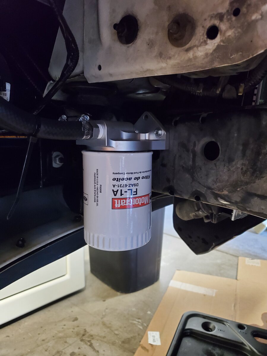

Remote oil filter kit from Jegs...
Tech details...
This kit doesn't fit a 4.6L out of the box. It comes with four adapters for the engine aide. I took the one with the smallest inner diameter, drilled it to 20.5mm, and tapped it to 22x1.5.
The hose clamps in the kit are crap and were replaced, after a line blew off in the garage.
