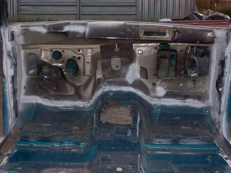

This was after I welded the '97 firewall to the '94 body. The primered areas above, and at the tunnel is where I found cracks. The gas pedal mount is to the right of the oval opening for the steering column.
I always forget to take pictures of the work done since I put it back together. I have been using the heck out of it offroad here though!
