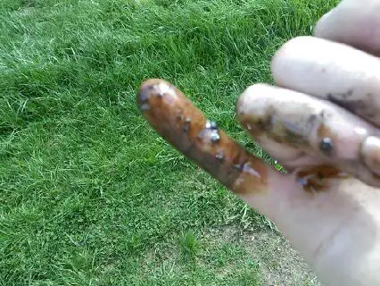

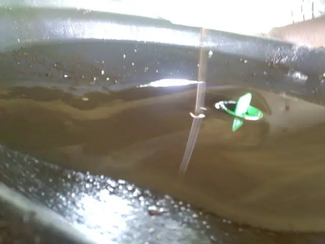

Well yesterday I found this in the transfer case,
And then I drained it today and found this,
So out came the 4405 and in went an M1354, :) but a storm all a sudden hit so have one bolt to tighten up, rear driveshaft to hook up, fill with fluid and and put skid plate back on and then mess with the linkage and we'll call it good for a short time :D

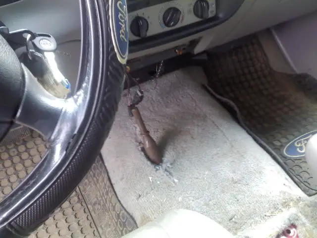

Got the shifter installed, don't have it setup like the regular setup, I can pull it straight back instead of puling back, over and back for low. The case works great. Have some touching up to do appearance wise but not mechanical wise.
