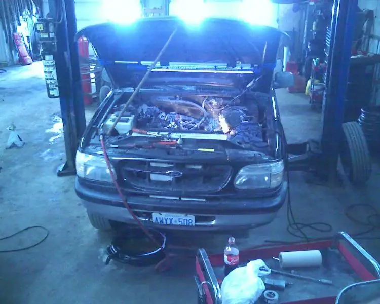

Alright, finally got a chance to replace the head gaskets and everything else today..
Got I crazy misfire, it's running rough..I'll post extra for the ones who feel like saying your two cents.
I know that info isnt enough, proably lean on bank 2 because the the misfire... But hears what happened earlier today, didn't see the lower intake gaskets in the package so in a bind I used this "the best" sealer to seal the coolant passages... didnt work, as I was cleaning up the shop I noticed the boxed seemed a little heavy and found my 2 gaskets, so I ripped it down and installed them... now my misfire.. also noticed I had a miss befor the second rip down when I started it but that went away after 30 seconds

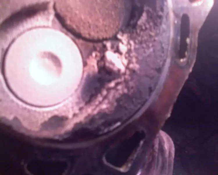

At first I thought it would be like the passanger side, 1-2-3... A buddy snapped a few shots with his phone, no wonder why I had bad gas mileage and pinging with no power

Was it due to the build up? Im trying to replace my heads on a 93 explorer so far i got the top off staring at the heads wtf do i do now do i need a torch to get the head bolts off or can i use a torque bar not 100% sure how to get them off they seem stuck if i spray wd40 will it mess with the engine at all.
