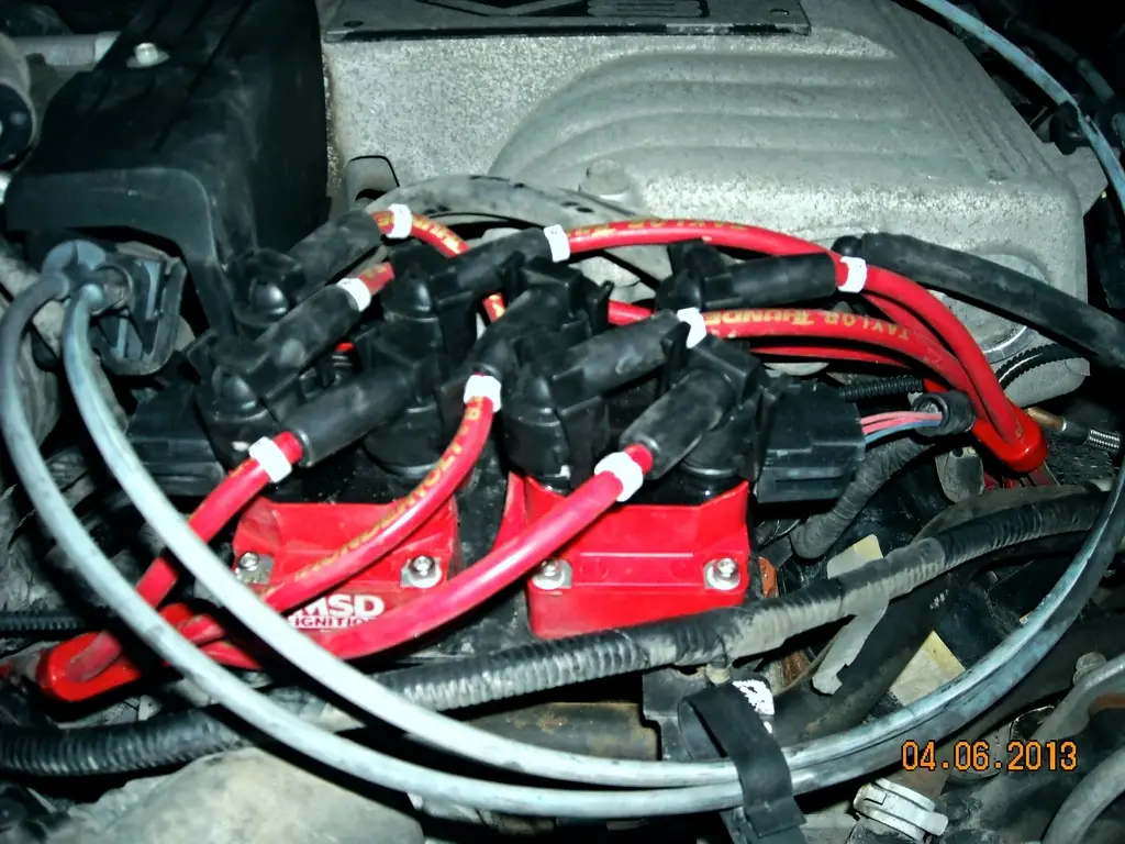

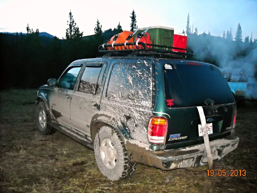

Got the new coils, plugs and thundervolt 8.2s installed and she runs so much better now... So we did some "testing".

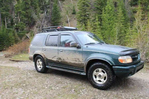

Nice. What rack is that I've been lookin for a roof rack like that
Great thanks love the truck what size tires ya got thete
265/75R16 or a 32x10.50, just needed a little trimming.

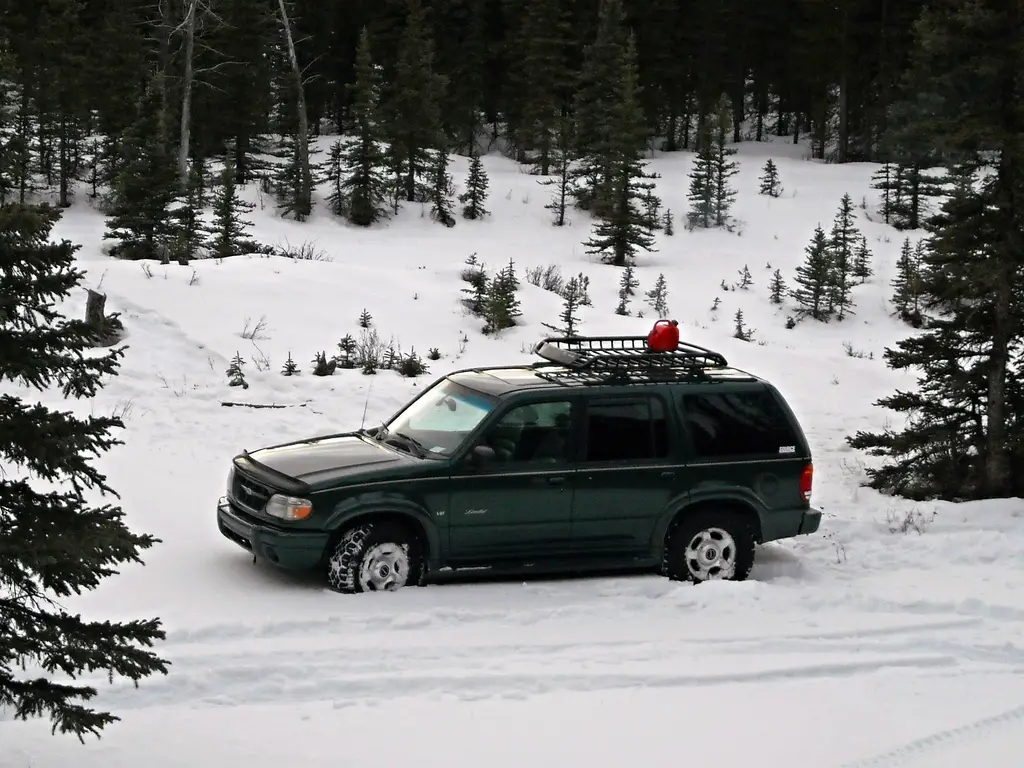

Thanks! Yeah the Duratracs are awesome, money well spent. Here's some more pics...

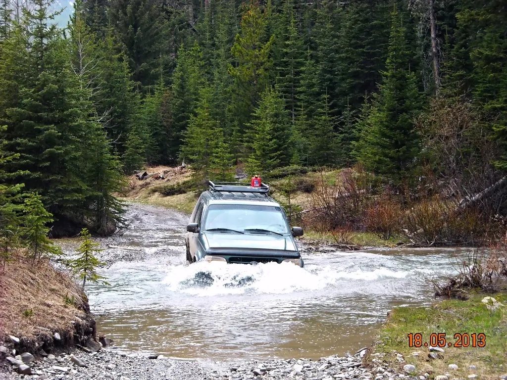

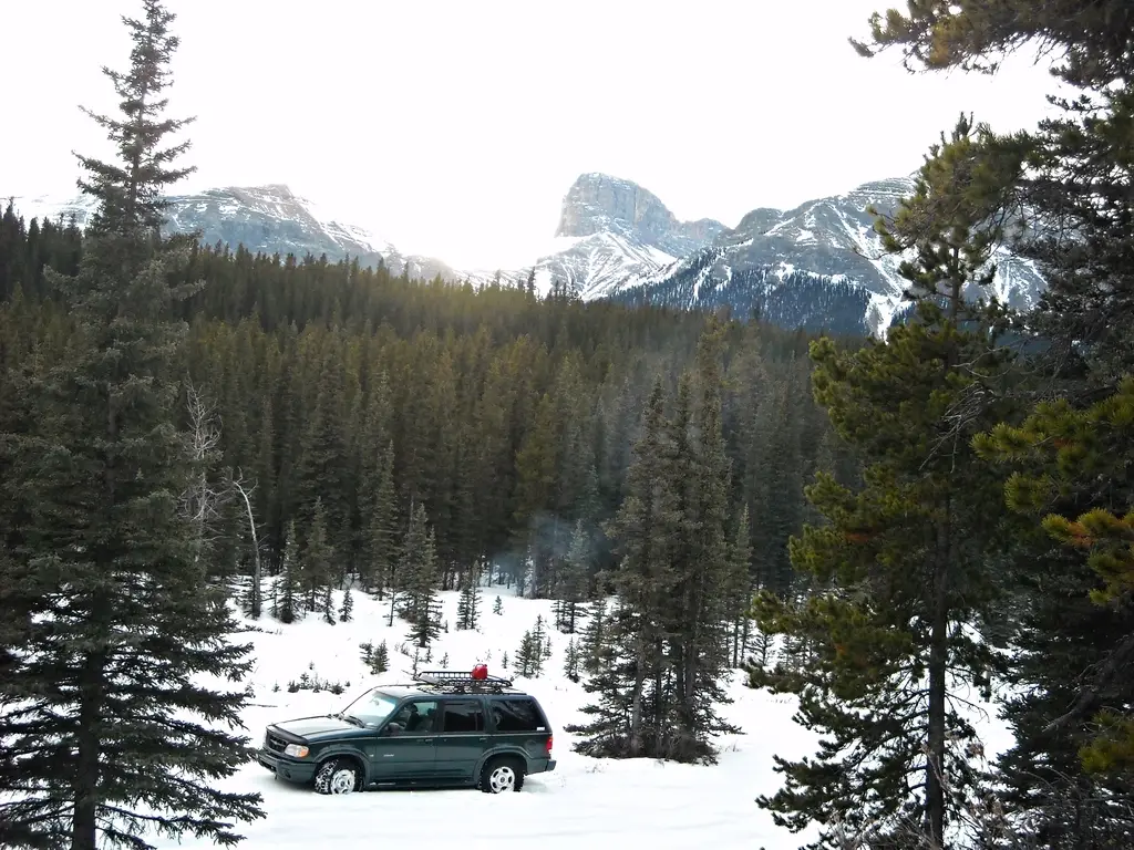

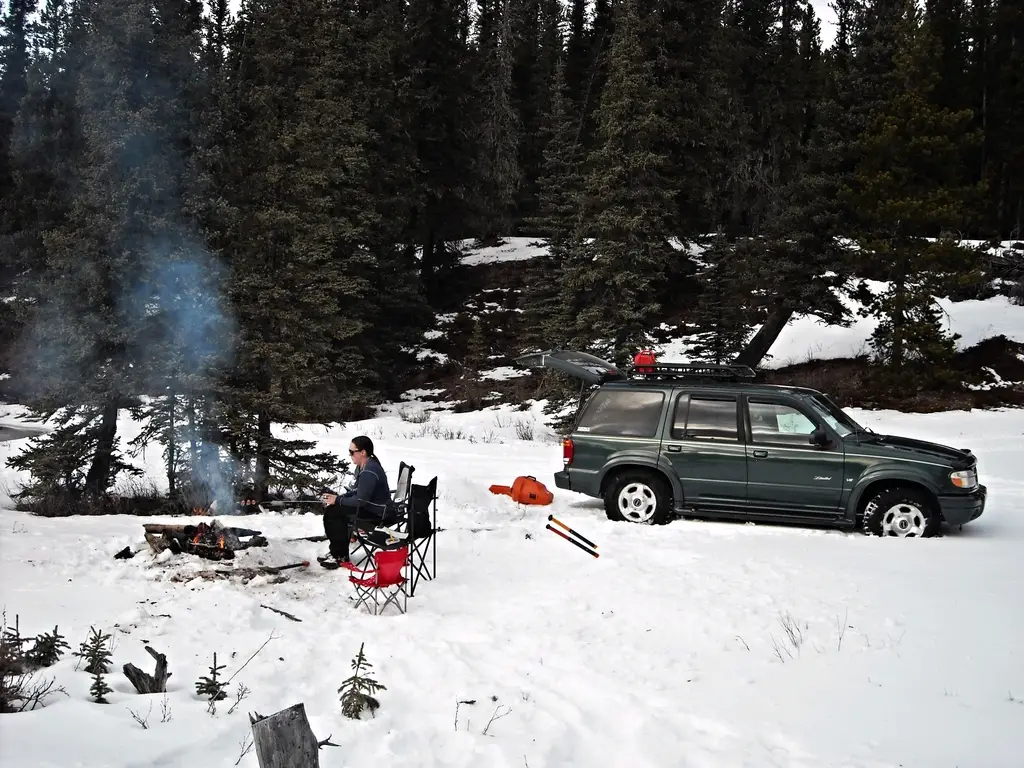

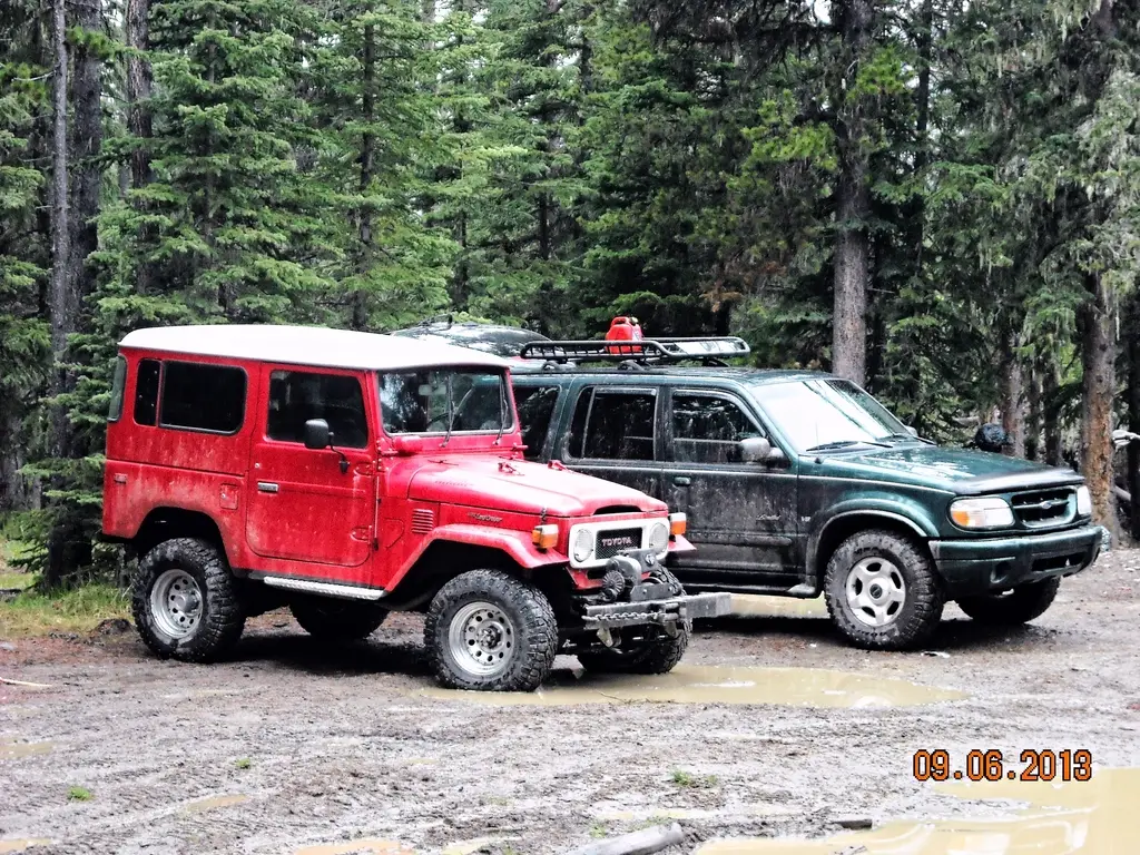

Couple more. This thing gets us to some pretty cool places for basically stock.
Awesome shot with my Ex in it from last weekend! And yes that's a Centurion in the back ground as well!

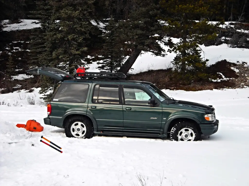

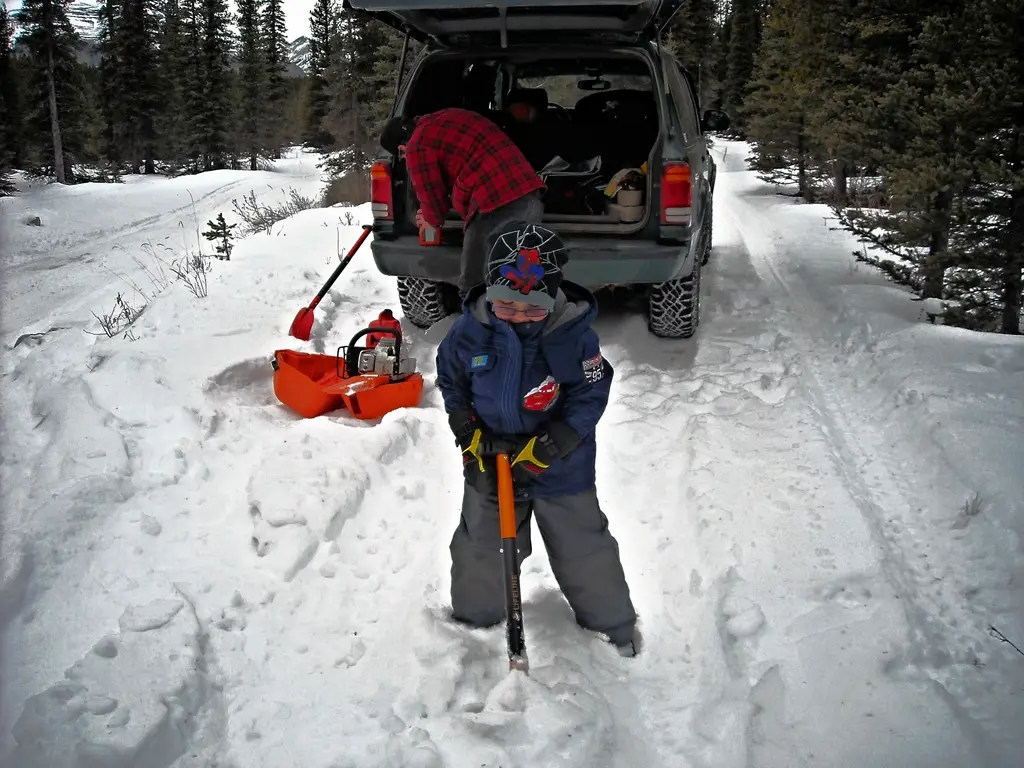

Got to go play in the snow and cut a Christmas tree.

What lift do you have on that and how's that size tire? No rubbing?
Also, where did you hook up your recovery strap?
Do you have a hitch, or is it connected to the frame?
I don't have a hitch on my truck, and can't find a good spot for it on the frame in the back.
Thank you!
The truck is still stock height (probably a little lower actually lol) I did some trimming to get the tires to fit and could still use a little more in the back as they rub at full stuff but I'm really glad I went with that size.

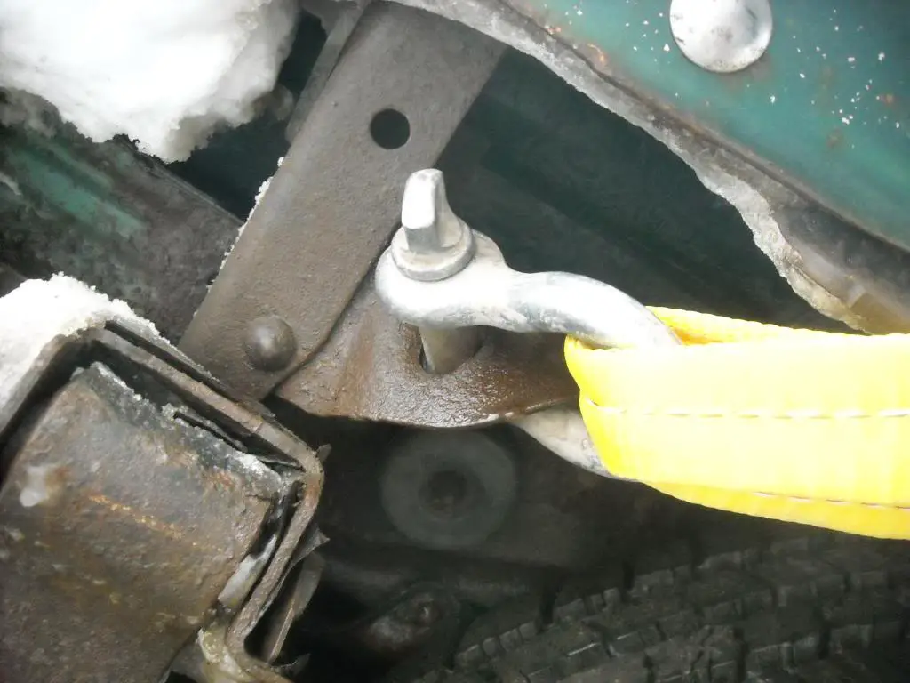

I have no hitch. I put 2 shackles through holes in the rear cross member and loop a strap through the shackles, not the most ideal set up but it works untill we can get bumpers made up. I try not to get too stuck...

Hmm, can you show me a pic of how you did it?
I tried hooking up a tow rope to my frame.. It did not end well.
Others have told me to use the stock bumper and wrap it around the tow ball, but I think that's a stupid idea.

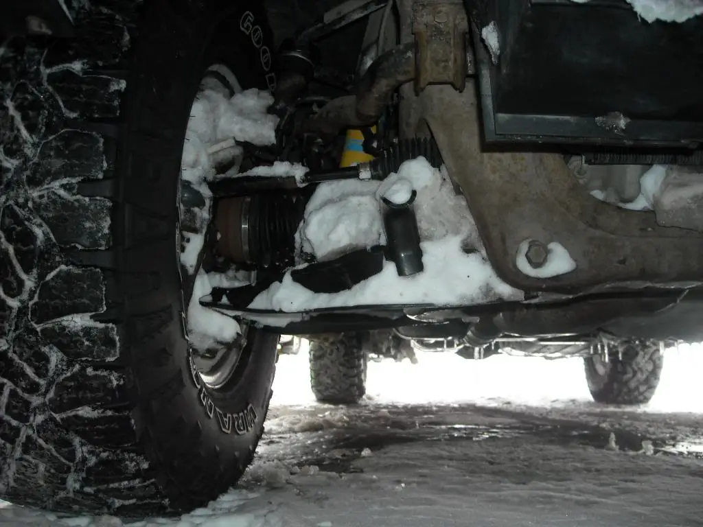

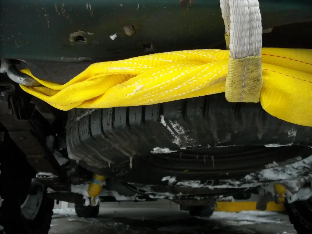

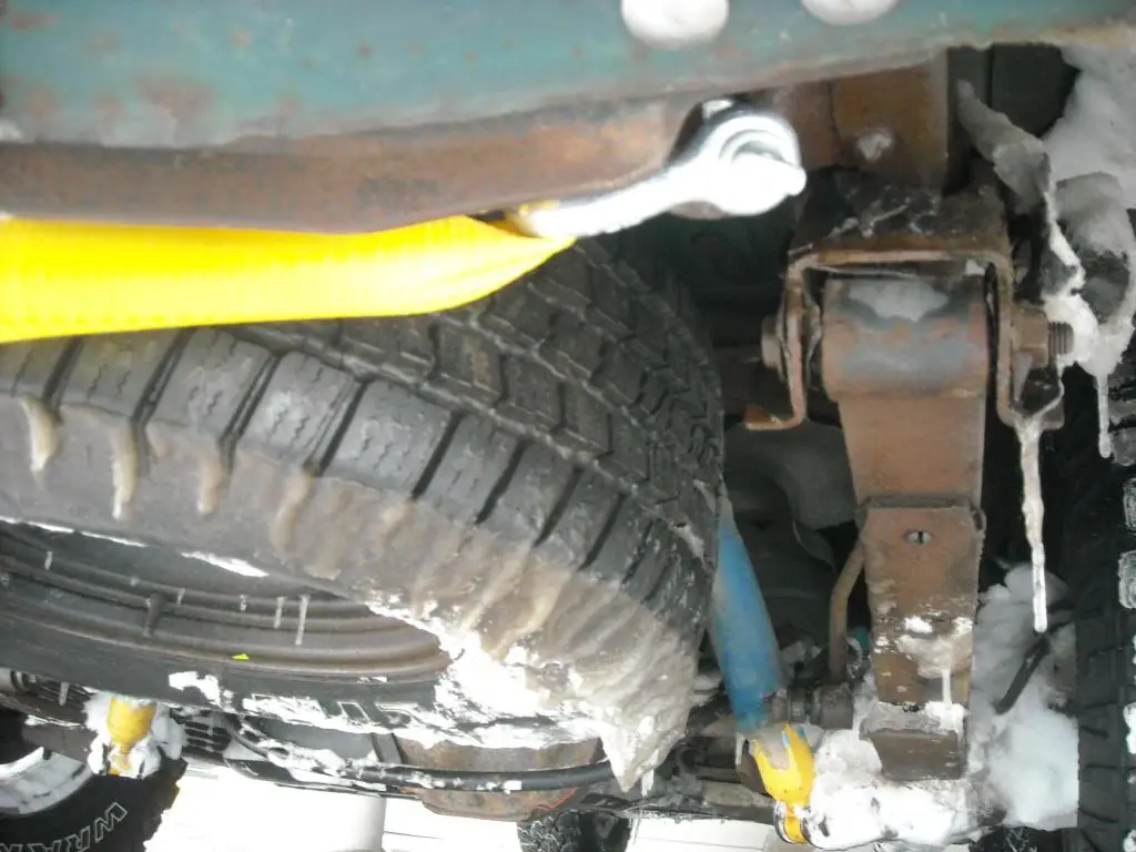

Hey DJ, here are some pics of how I mount my strap.
I've been having some fun in all the snow and needed a pull the other day so I snapped a few :chug:
