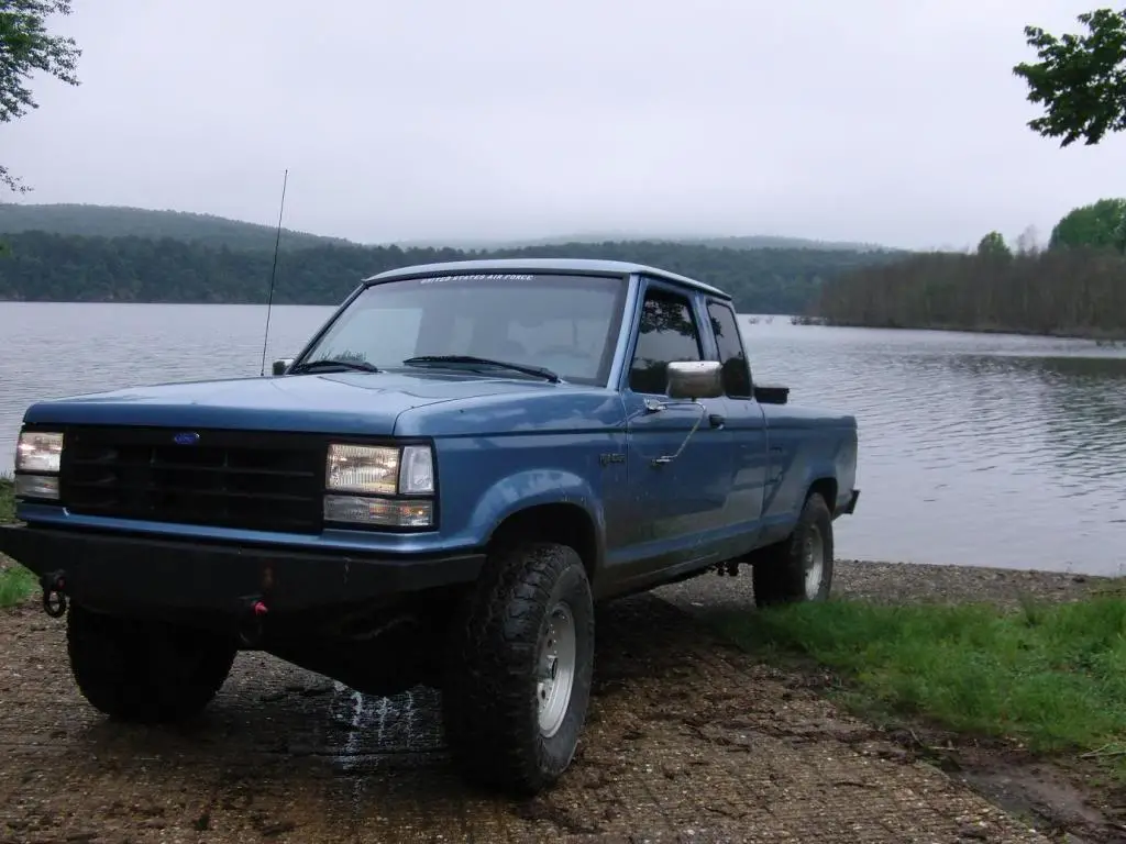

Well I have mostly been on the ranger station but lately I have been looking at a lot of tech articles on here so I figured I might as well join.
Here is what my truck looks like today:

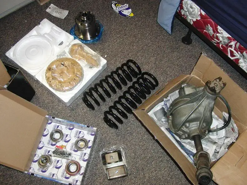

Right now I am getting ready to do some major changes. I have a 31 spline 8.8 riding around in the bed soon to be getting 4.56s and a detroit locker (should be here tomorrow). I also have a 4.56 geared D35 in my room waiting for all the parts to come together (and a lock rite), as well as 2'' lift coils and an AAL.

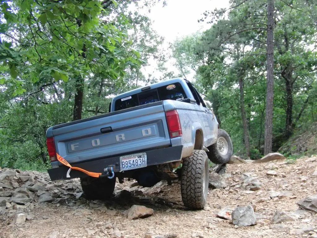

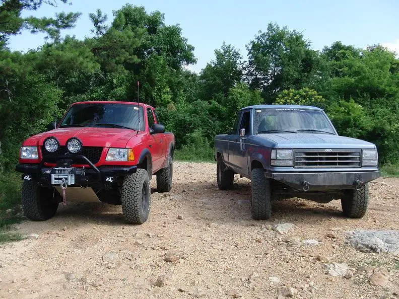

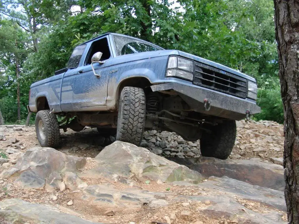

Well I ventured down to superlift orv park again and met up with ScottyJ. He has a pretty cool ranger
After wheeling with him on 2's for a few hours he took off and I met up with some guys from Arkansas crawlers 4x4 club. They were all really nice and we went and did some lvl 3's and lvl 4's (rubicon ridge and gulch). I didn't think my truck would be capable of doing some of they stuff we did lol. I unfortunately only got one picture.
This adventure makes me even more ready for my axle/gear swap! And I can't wait for a front locker and bigger tires!

Well I figure I might as well update this thing. My new exploder 8.8 is under the knife getting the gears and detroit in it right now. I sold the 2'' lift springs I had and just went all out for a duff 3'' lift. I also got some extended radius arms and tranny crossmember. Basically I am just waiting on the axle to get finished, shocks, brake lines, bushings and it to cool the #### down lol

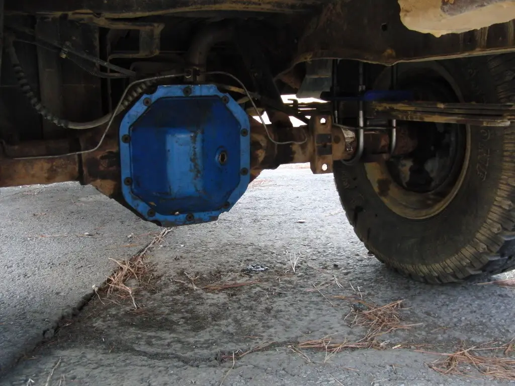

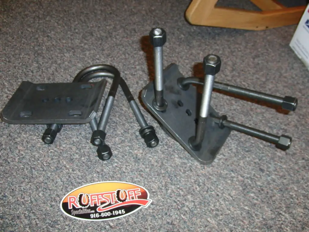

more axle parts showed up today! .375 u bolt plates and 3 1/4 x 5/8 u bolts. This is some beefy stuff, good job ruff stuff!

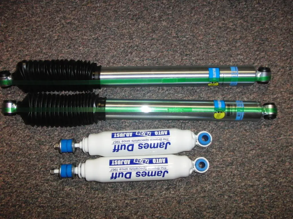

5125s for the rear, and the duff stuff up front. 4 day weekend and payday coming up, time to get shit done!

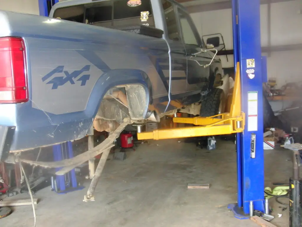

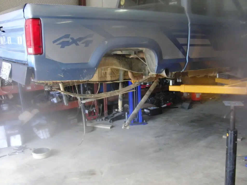

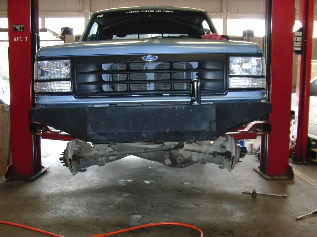

Well went into the shop today to get my extended radius arms on. I was really excited. Started at ten and got it up on the lift and started taking shit apart.
About 4 hours into disassembly I have both old,radius arms removed, hubs and calipers removed and the axles supported. The old rad arms were a major PITS to get off all four bolts had to be torched and then hit with a big ass impact wrench. Then I move down to the fun stuff and start getting the new radius arm brackets mounted. I go to get the new tranny x-member in and it does not mount up properly. On one side its about 3/4 inch to far out and the other side about 1/2 inch to far in. FML. Reassemly begins. And its way harder to install the beams and shit lol.
Total time spent: 8 hours. Total accomplished: 0.

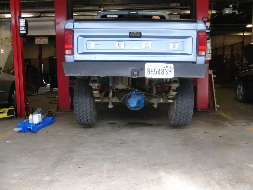

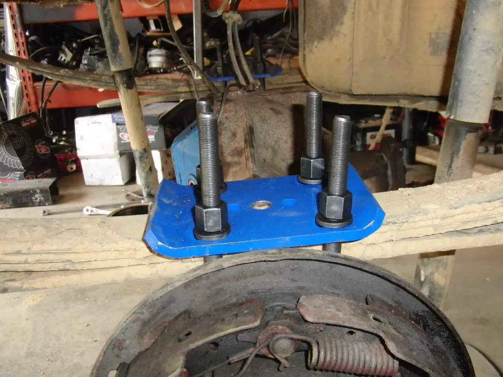

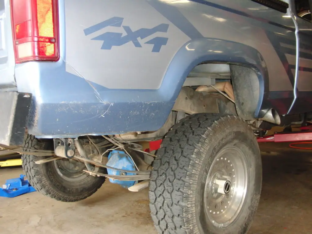

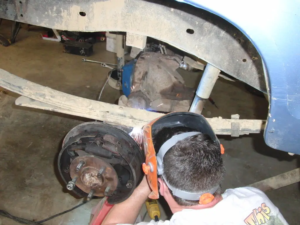

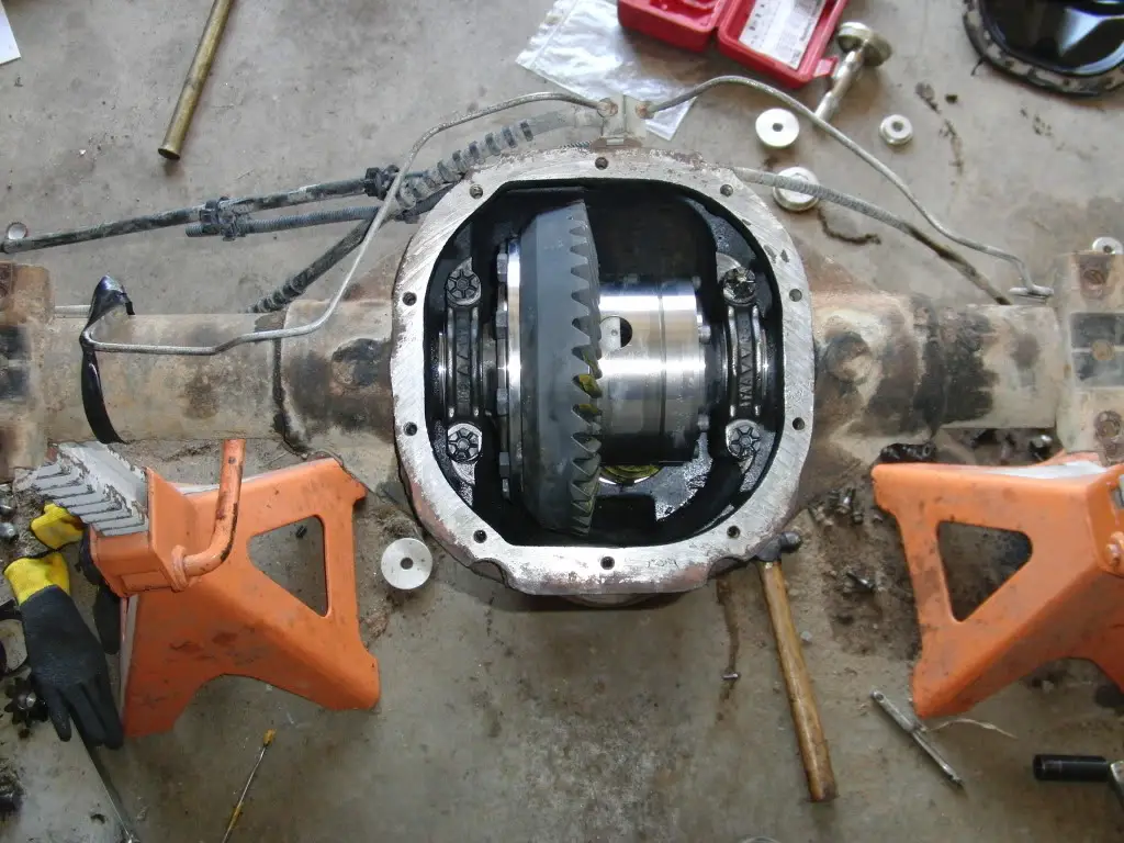

Well the new 8.8 is in:yahoo:! And I am way over geared now lol, but my clutch is enjoying it. Took about 5 hours to do the swap. The guy that put the gears in was kind enough to let me use his shop!:headbang:
The new stuff
This is for the passengers lol

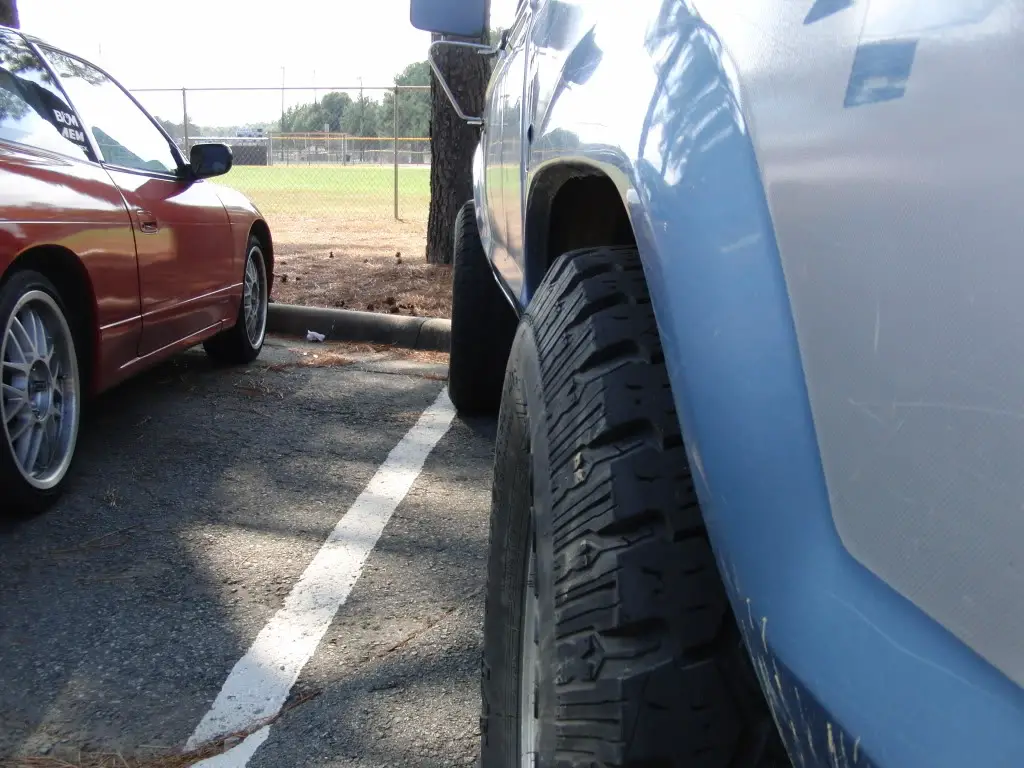

Tires match the front width pretty good now
