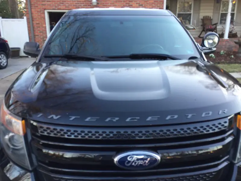

Hi all. I have a 2014 PIU. We have had a cold front move in for the past week (upper 20s at night to mid 40s day) I have noticed that my steering has intermittent squeaking in the cab and the wheel is stiff at some points of the steering. Like if low on fluid. It doesn’t want to come back to center always. It tends to get better as the day warms up. Any suggestions?
