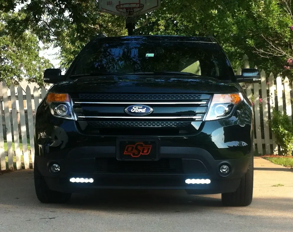

Here's my install:

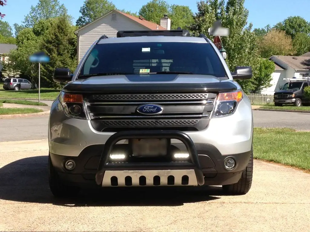

I installed the Philips DRL LED 4 kit. Extremely easy and the lights are very bright.
