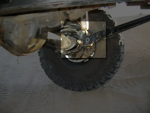

A wristed arm is stock length with a "pivot" in the arm to get more flex as well. Here is mine.
You can get the coils to work on anything with some fab. :)

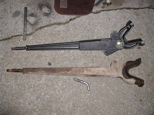

that's what i figured. i figured you'd just rotate the weld on "c" brackets about the axis of the axle. but yours looks like you took a bolt out and it's just connected with one bolt?
Yes, just one bole so the rest of it can move. Here is a better pic, and it can rotate both ways:
oh i see. So this allows your coil angle to be correct, right? Just to be 100% clear(i guess i'll find out sat when i pick up my parts), there are two bolts in it from the factory, and you just remove one? i can't tell very well from the pic because the lower one is dirty and rusty and i can't see any bolts. also, can you give me a general idea of how high the coil bucket is positioned on the frame rail? i plan on using wildhorses4x4 5.5" lift coils.
The stock one comes with the rivets to hold that shock mount on and that's it.
those are the same coils that a few of us have and it all depends on how much lift you want. Look in the off-road forum section and check out the threads of the ones that have already done this. That will help you out more then me telling you anything. Just read and research a lot and then ask the questions if you can't figure it out. Good luck. :cool:
Oh, and it doesn't allow your coil angle to be correct really, it's just a way to get more flex out of the front end. It actually makes the axle move towards the rear of the fender with the way thay it "wrists".
So do you use that hitch pin to hold it solid on the street?
That's what it's for yes, but I leave mine out. It's really not needed.

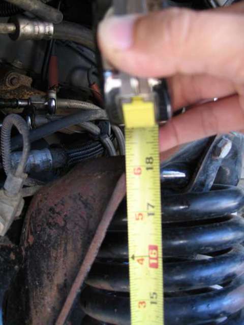

oh okay, i see. yeah i'll do some more research about the wristed action. i'm sure it'll become obvious when i get my axle tomorrow. i'll have the truck level, and the rear has SOA and lift shackles, so i'm guessing about 8" of lift or so in the front from stock. i plan on using wildhorses4x4 5.5" lift coils.
Just for reference, those WH 5.5" coils compressed with the weight of the explorer should be right around 18". That should help you decide where you need to put your buckets. :thumbsup:
For ***** and giggles (because this pic was right next to the last one i posted), this is what mine looks like.
