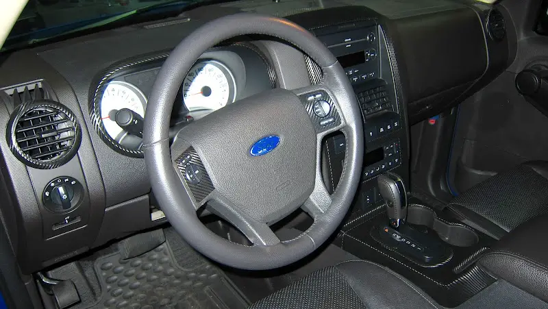

you can wrap the chrome in vinyl. I did this with a heat gun and some 3M 1080 carbon print film, oh and a lot of patience!

That looks gorgeous! I bet you could make a good buck doing that service!
That looks nice! I might try that on the handles

The nice part about the vinyl wrap is that, unlike paint, its totally reversible. The 3M 1080 comes in many colors and textures. Do a google image search for 3m 1080. I bought my material from metrorestyling.com

Remove the gauge bezel surround first, by removing the panel below the steering column, then the whole plastic panel that goes up to the windshield. the chrome trim around the gauges does not separate from the black plastic panel so you will want to take this whole piece out to wrap it.
Once the gauge panel is off you will have access to the back side of the drivers vent, and can press off the tabs that hold it in. It's pretty tight back there but if you get one tab off it helps removing the rest. each vent has three tabs.
On the passenger side, drop the glove box and you can access the back side of the vent the same way you got the drivers side vent out, it's tight but getting to the back side of the vents is the best way to not break the tabs that hold them in, because they don't pop out easily.
