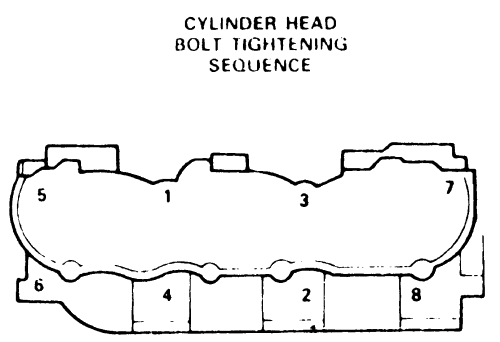

This is taken straight from Mitchell Manual...
First Step - Tighten to 44 ft lbs.
Step Two - Tighten to 59 ft lbs.
Step Three - Tighten each bolt an additonal 80-85 degree turn (Full 90 degrees is fine)
Tightening Sequence is shown below...
