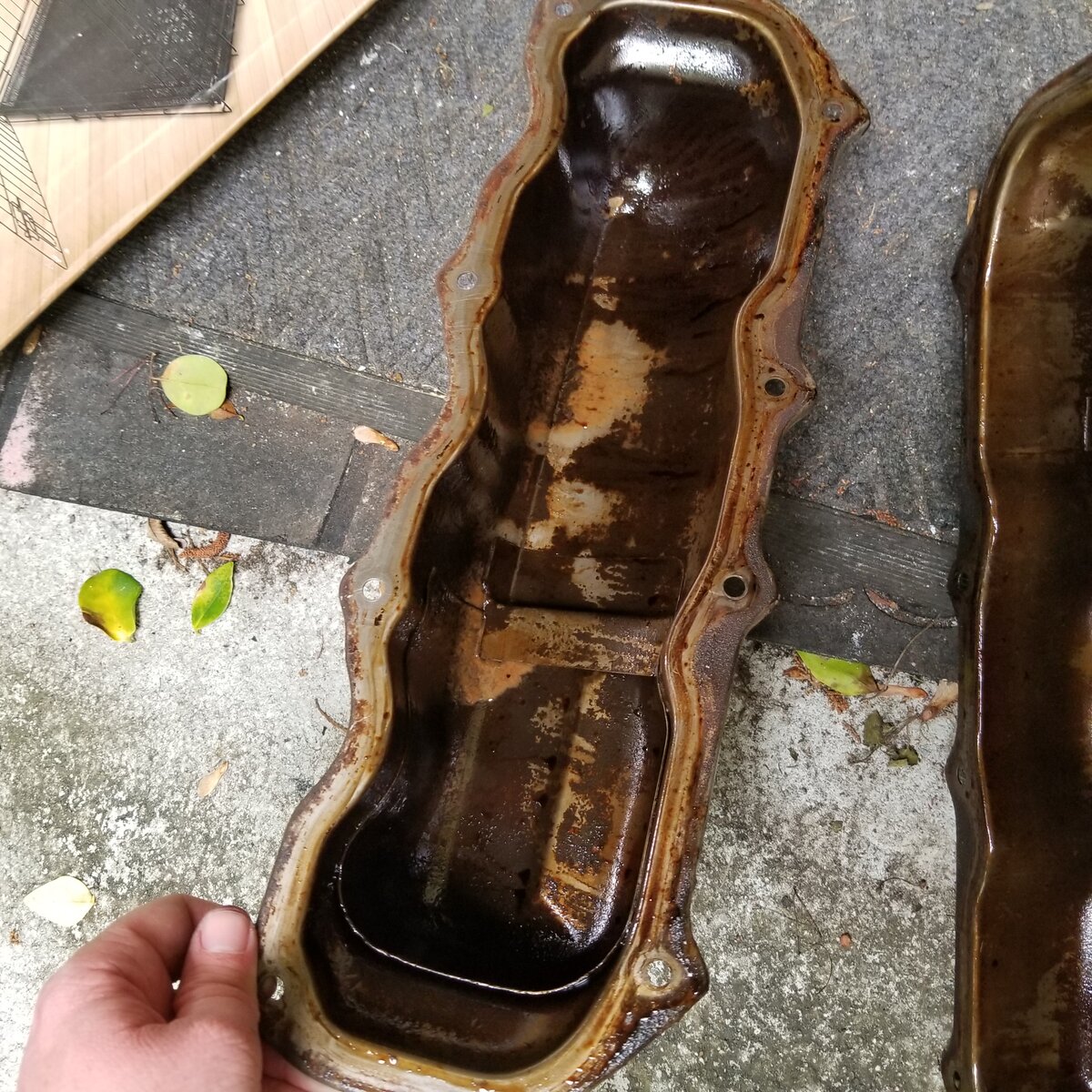

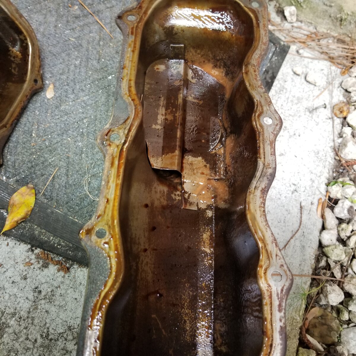

I assumed it was the head gasket which I replaced myself about two years ago. As I am taking off the plastic intake to do a compression test I see there is a little bit coolant inside of it and around the edge of where the crank case hose attaches to it. The weird thing is I can't see coolant in the oil and the oil levels are normal. When I took the intake off two weeks ago there was some oil in it which did look a little cloudier than normal but I didn't think much of it just thought maybe it got wet or had some humidity in it but this is definitely coolant. The throttle body is dry so it is weird there is coolant apparently coming from the crank case hose?

All 6 cylinders are right at 125 psi. The cylinder 4 plug was wet with gas so I guess it was not getting spark. I see oil leaking from the rear of the driver side valve cover but oddly the rear two plugs were very corroded and didn't want to come out.

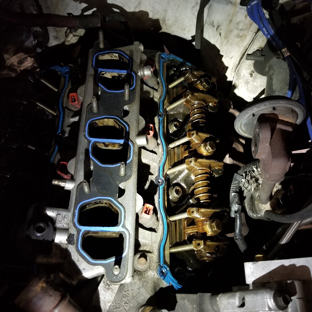

The ball of this pushrod is showing way more than the others which is a little concerning since it is the same cylinder with the fouled plug but I got 125psi on that cylinder. Trying to decide if I should pull the heads or change the lower intake gasket and trouble shoot that cylinder.

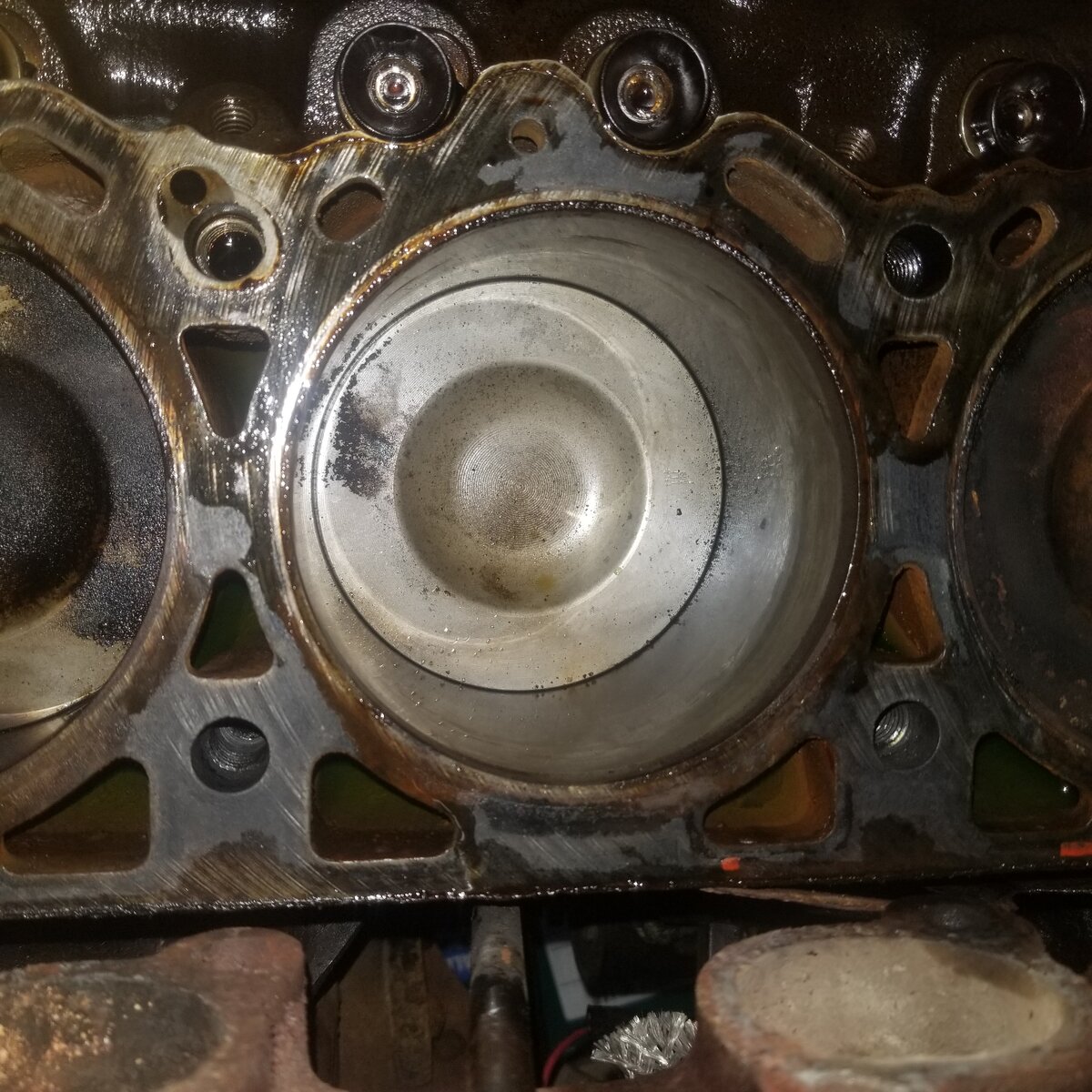

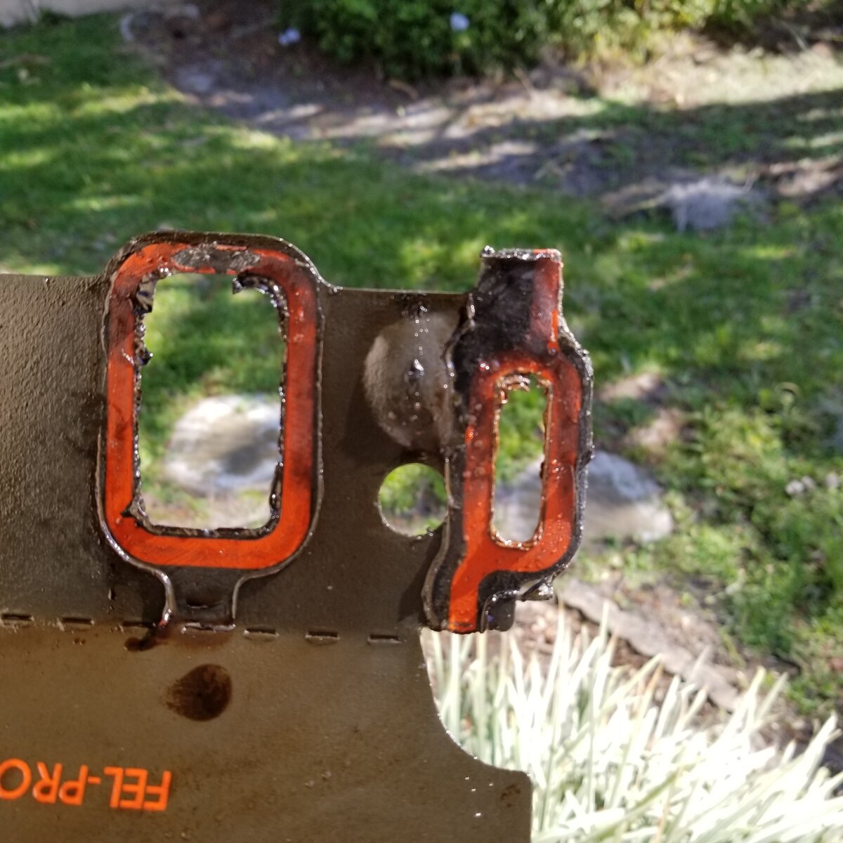

Thanks man! So I ended up pulling the heads and it seems there was coolant getting in the cylinder. Cylinder 5 was completely clean and 4 seemed like it was on its way. The cylinder 4 plug was also fouled with fuel.
I believe the headbolts were defective as the 2 inner headbolts for cylinder 4 and 5 were not near as difficult to break loose. I used felpro head bolts as they were cheap and I always used there gaskets but as I was looking to purchase the headbolts to redo the job I found alot of bad reviews on them.
