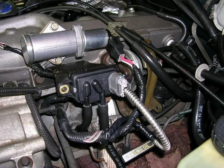

Not the EGR itself, the two hoses going to the EGR sensor that tap off of the exhaust pipe to the EGR
