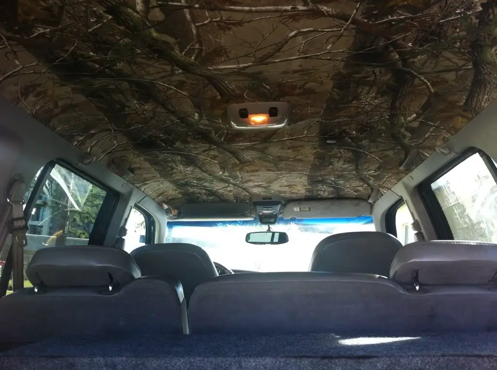

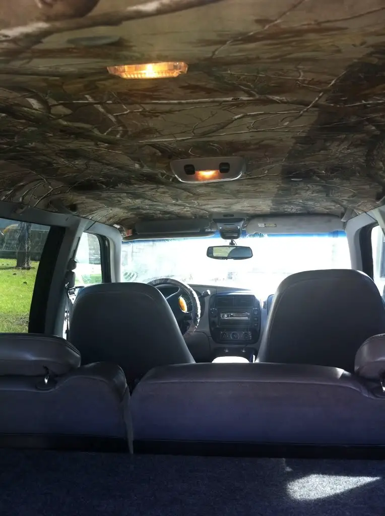

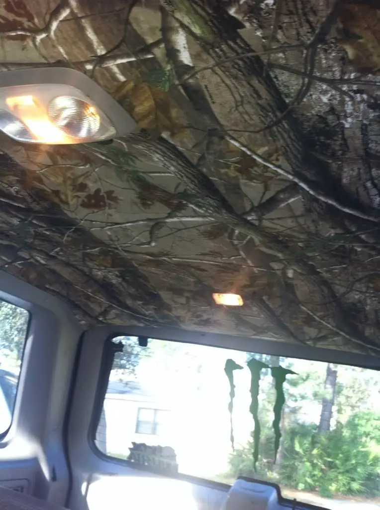

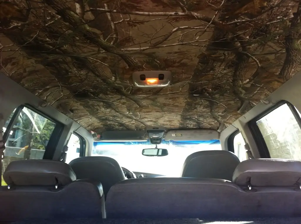

I just did mine before Christmas on my 97 ex. I did a camo theme came out dope! It was pretty easy! A few yards of fabric from Jo Ann's and 2 cans of adhesive from advance auto! Took total prob 2 1/2 hours

I did it over the old fabric. I think it stuck better that way. When I did It I layed the fabric over the whole headliner then folded it back an started from the middle And worked my way to the ends.. I would get two cans of spray adhesive just to insure it sticks very well. after it all is sprayed on and dry I cut all the holes out.. But make sure when you run the fabric to the edges you can run a little of the fabric tO the other side and spray that as well to better the chances of it no falling!

Ok thanks. Yours turned out really great.

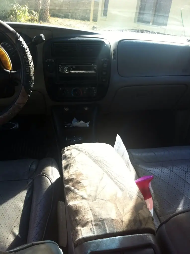

Thanks I like it! Now just gotta get the matching seat covers :)
