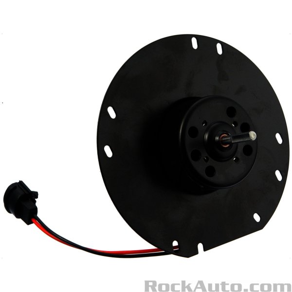

@StonyPointer
Hope the following info helps you!
OK - If you can GENTLY remove the squirrel wheel fan from your Blower motor, ROCK AUTO sells JUST the motor.
The blower motor is manufactured by VDO / CONTINENTAL, for just $18.37 plus shipping!
The part you need is: VDO / CONTINENTAL PM271
NOTE: It's the same blower motor for a 2001 EB Explorer regardless if you have a V-6 or V-8
