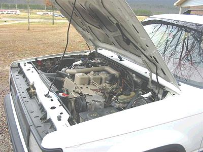

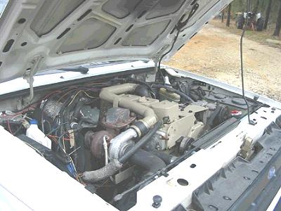

I imagine I found these pics on explorer forum somewhere along the line a long ago and saved them to my computer but I really dont remember. Looks like a factory install thou. If/when I get another explorer I would really like to do this swap as well so if you plan on actually going through with this I sure hope to find a nice how to thread with plenty of juicy pics and factoids on how to make it all work ;) A few problems to overcome in some regards such as intercoolers (if equipped, where to cram) Fuel system wouldnt be too much of a problem if it relys on mechanicals to get the fuel to the injection pump and of corse electrical :p Painless wiring recently released a harness to swap cummins I6's into various branded trucks, they may have somthing for you (if this engine is even electronically controlled :p I havent really looked into it at all)

If you want to get some serious info on a Cummins repower go to www.4btswaps.com.
Lots of good people and loads of information. I think I saw that explorer on there once before...it gives me hope :)
