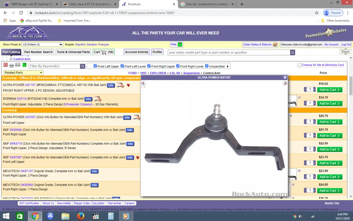

The front a arm looks about the same only difference on the 97 4x4 is it is a 2 piece and adjustable. Rock auto shows the same one as a replacement for the 95 5.0 2wd, are they interchangeable? I do want those aftermarket shocks that came with it.
***nevermind they also sell the one piece upper a-arm for the 97

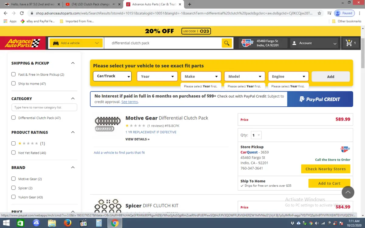

Is it something like this?

That sounds right, and the price is close, Motive is a good company. I have the small brown box out in my garage in my 99 somewhere. If the application info is correct and says for an 8.8, that should work for all 8.8's.

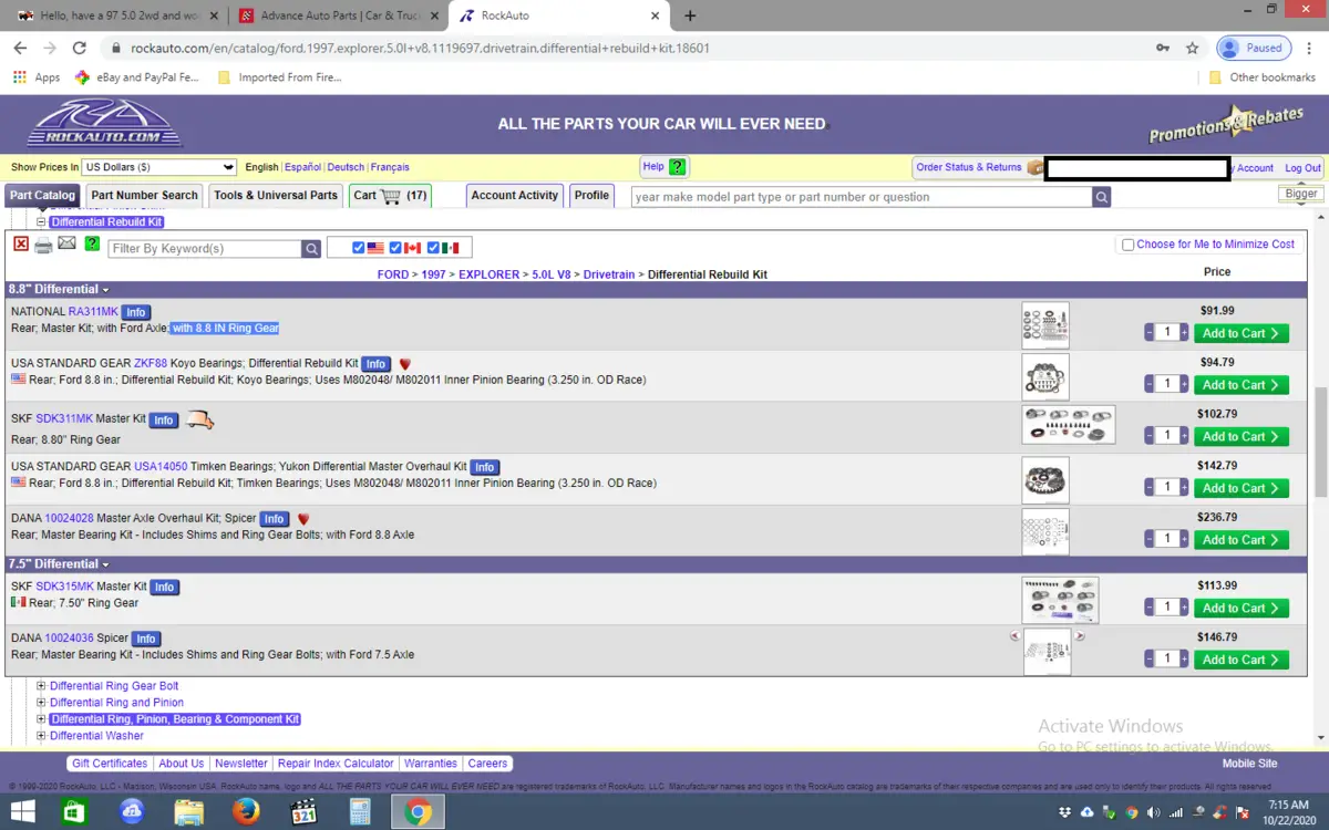

Found this complete kit on rockauto, you think this is a better buy?
CDW6212R
Hauls the mail.
June 17, 2004
20,360
1,464
Knoxville, TN
98 Limited AWD
Those are actual diff, rebuild kits. You shouldn't need any of that unless part of the diff are damaged, like pitted gears etc. Axle bearings are found near that under Explorer on Rock Auto. They are a great source if you can find things in their system, it's good for part number searching to, or get the # there and look outside to say Amazon. Different places will have different pricing, and ship times etc.

Is the wheel bearing kit and the differential repair kit the same parts?
