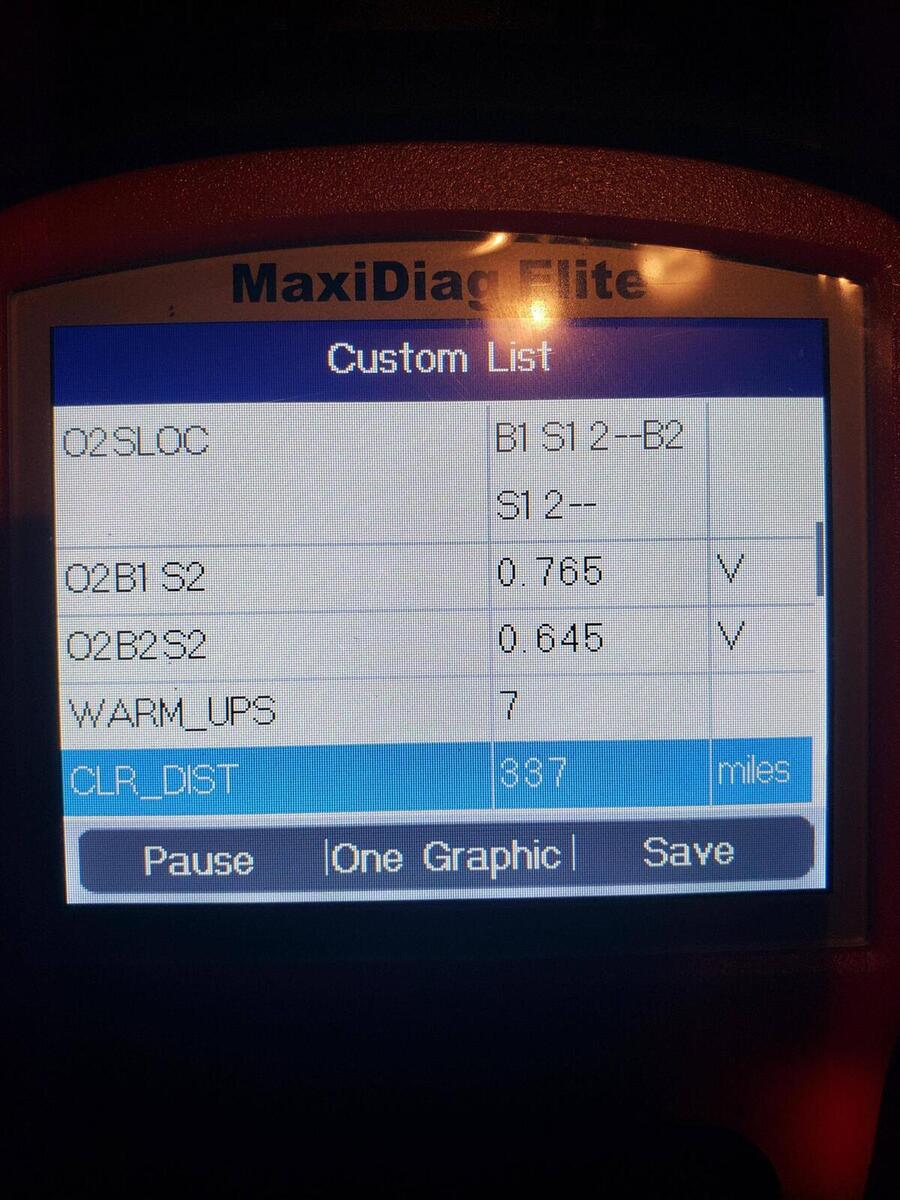

Here are the sensor readouts. The engine is up to operating temp.

Just to show the problem visually. O2 sensor monitoring incomplete, O2 sensor heater monitoring incomplete. I've put over 5,500 miles on the vehicle since buying it, and I've done the drive cycles over and over again.

Could be an exhaust leak. .. When you do the drive cycle u gotta start form cold and get the catylitic converter all the way hot like super hot like 1hr of driving without shutting the car off and try to not idle ugh well anyhow I had the same problem and when it did finally say ready it came with po420 cat below efficiency not saying that's u...voltages look good. Well when u do if u can live stream scanner coolant temp needs 2b within 11 degrees of air intake temp when starting or it won't compete u could get it going by flooring it for a second several times every once in a while going closed/open loop over and over can kickstart that proscess.That's says u have only gone 337 miles since cleared : / and 7 warm ups... U can do this with 1 drive cycle if done correctly and don't clear anything else u need 02 / maf sensor data to be stored preferably... From what I see on the data everything looks good the 02 sensors heater looks iffy...try to get cat up to 1500 degrees the sweet spot for the 02s21 is .045v u were almost there could take just a few minutes under at .045v to fully complete. U could havea weak battery if u haven't manually reset recently that's it. Car needs to stay above 13.8v always when running and 12.? When off or it will reset. Did u check for stored codes and pending? If u have perminant stored codes with no check engine omg can be nearly impossible to clear because the car has to meet those same conditions to set to make sure all clear temp speed ECT... Pending is another story. Totally normal btw with only 7 warm ups...
To clarify, what you're seeing is the data since last time I had the battery disconnected, which was when the shop replaced the O2 sensors. Since then, I've run countless drive cycles, and obviously 7 warm ups here. But since purchasing, I've driven it almost 6,000 miles. That is PLENTY of time to ready up... Something is wrong, more than the amount of warm ups It's had. Battery is a brand new Duralast Gold, size 65 with 850 CCA's. Alternator is healthy, puts out between 13.8 and 14.8 volts (higher while driving of course). Battery is a constant 12.6-12.8 volts when vehicle is off. (I have a phone charger that has an accurate digital display voltage readout, I have checked it against a multimeter and it's accurate). I definitely floor it a lot getting onto the highway, not gonna lie haha... I like the feeling of acceleration this thing has, really plants you in your sest for a heavy SUV!
Over the course of me owning it the past 3 months, absolutely ZERO DTCs have come up. None stored or pending. I check often because of the problem. My Autel has an IM readiness checker and the only two things coming up as Incomplete/not ready are the O2 sensors and O2 sensor heaters.
I've done several 3-4 hour drives across massachusetts (and another 3-4 hours back) doing 70-95mph the whole way... Yeah, I do drive fast haha, but I've definitely given it an opportunity to get the cats extremely hot. Especially flooring it on the highway. I've also tried babying it, driving only up to 65 using cruise control for the drive cycles, very gently getting on the highway and slowly accelerating. Also did the thing where you speed up to 65, stay there for a few minutes and then you coast to a stop... That was not easy to do on public roads, but I did it at night each time with no cars around on a long straight state highway called Route 88, no cars around. But anyway, I managed to do that, and all that that seemed to accomplish was teaching me that route 88 is very quiet at night LOL. Each time I did the drive cycles, I would always start from cold. Again, trust me, I've done the drive cycles over and over again, three different shops have done the drive cycles too, two of which put the car in force-ready mode, all to no avail.

Going over the data again I'm seeing actually negative 02 sensor reading I didnt catch that at first.... So deff a problem 02 sensor reads oxygen levels inside AND outside the exhaust they suck up 02 around the wires from tiny pores on the outside by the wires.... Any how the greater the difference in oxygen the HIGHER voltage will be.... This indicates the air inside the exhaust is more "Oxygen rich" than on the outside....impossible....02 needs to give positive .02v to .08 not negative. Sensor bad idk how the techs didn't see that....without the negative it would be OK to pass...inspect the outside of all 02 sensor wired at the base for grease or blockage... Wiggle the wires really well the small pores on the base is blocked... They need microscopic amount of air to breathe at least...Or faulty I'm guessing deff downstream. I'm guessing u got data once hot and cold maybe either way negative is deff a problem... It would help me to know more data full shot with stft short term fuel trim...lmk if it's upstream if anything other than 0....or 1.....get all the data when got only.

I can get live sensor data if that helps. Any ideas, folks?
U did kinda woul like to see cat temp along with 02s1 02s2 maybe with stft and if possible evap purge command data cold and hot.
