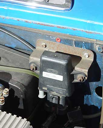

BAP sensor:

oh ! ok thanks so basicly what does it do ?

Measures barometric air pressure. If you didn't have one, your fuel mixture would be off depending on the air pressure of the ambient air.

ok thanks joe ! & update i got the new MAF installed & it acting better !!!! but couldnt find where the BAP was on my truck. & it still shutters a little bit but has plenty of power so i`m off to find where the BAP is hiding tomorrow LOL

but its not fixed yet :( cant find the freaking BAP/MAP sensor location on the 95 v6
Did you ever find rhe BAP sensor?
