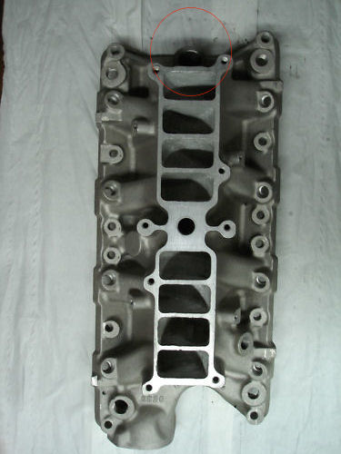

The big end of the PCV is SUPPOSED to plugged in here:

if it rattles then its fine if you move it and it stays then its no good. i can't remember where the other end of the hose is attached to. when i first started answering i had just reinstalled my upper intake after replacing an injector. i slept since then. lol. if its rattling just put it in the hole that was circled in the pic

grab the big end and tug and twist a little and it should come free of the hose. its just pushed in the hose and has a single barb holding it in. it could have been out of the hole a while or you may have found it and knocked it out without realizing it. when i first got my truck this little bugger gave me hell. cause i had no idea where it came from. i was on top of the engine looking with a light (hood was off for a blown head gasket rebuild (had planned on pulling the motor and replacing it ))and feeling around and when i took the connector off the firewall it was super easy then. you have to be a contortionist to work on a v8 ex. lol.
So after I replace it I need to plug it back in where Spdrcer34 showed in the picture above. Can I feel the hole on the case easily?
