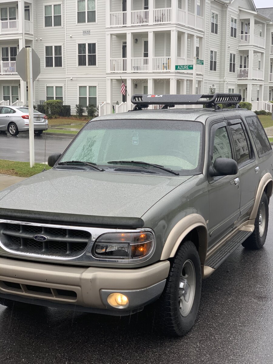

I have a 2000 Ford Explorer Eddie Bauer 5.0 AWD and I want to put 33’s or 35’s on it. I have not been able to find suspension or body lifts for it. Any suggestions would be great.

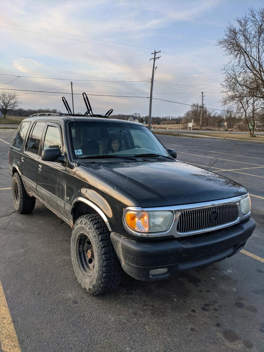

Hello, I have an 01 Mountaineer 5.0 awd and came across the same issue. I have 31s, no lift, minor trimming was needed. I daily drive mine (expressway mostly) and two track/camp/kayak. I want nothing over 4 inches in a lift. No bigger than 35s when done. I have searched for hours and came up more confused then I was at the beginning of my searching. 😖 photos show part of the trimmed bumper. Eventually I’d like a brush guard.

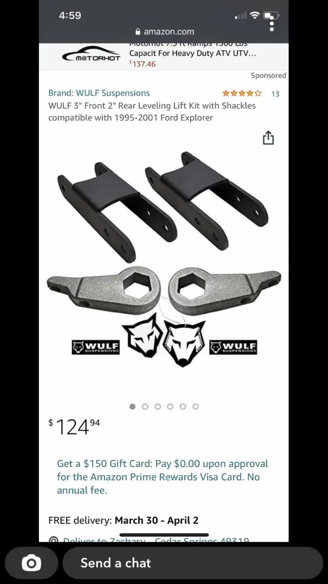

I came across this, got 3 opinions on it. All 3 said yes that’s what you’ll need for an 01 mountaineer awd 5.0, I’m sticking with 31s. Dd and trails (nothing major).
Experts wanna tap in on this before I hit click it’s mine....
That will go onto your Mountaineer. That's the basic thing most people do with their 2nd gen Explorers.
BTW, note that the springs on the Mountaineers are not the stiffest Ford installed, those came on 4WD Explorers. The Mountaineer got the softest springs, front and rear. So you will likely want stiffer springs if you have some bottoming out in the back regularly. Any will swap from other Explorers(not the 2dr Sport models), if hunting just remember the 4WD models got stiffer springs in general.
Before buying that kit try and adjust your t bars as is. You might be able to get a few inches out of it as is.
You can usually get 2" with a torsion bar twist and rear shackles. The torsion bar keys in the picture you posted are made to allow more twist which equals more lift, but often you can get what you want without those................................I prefer a suspension lift like this to a body lift. Anything over 2" lift and you need a body lift with the above or a kit for the front suspension. and some welding to go axle over in the rear.
