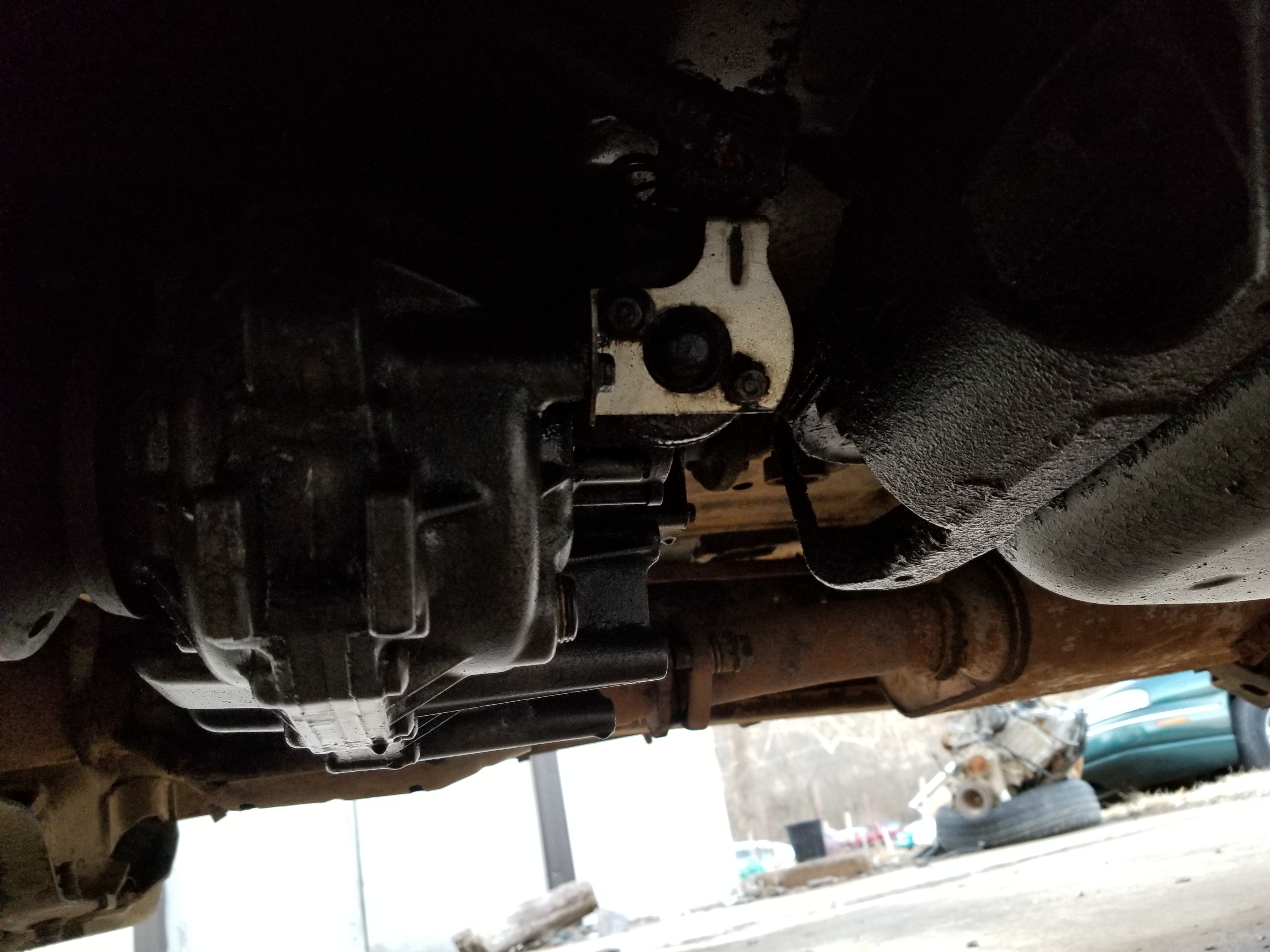

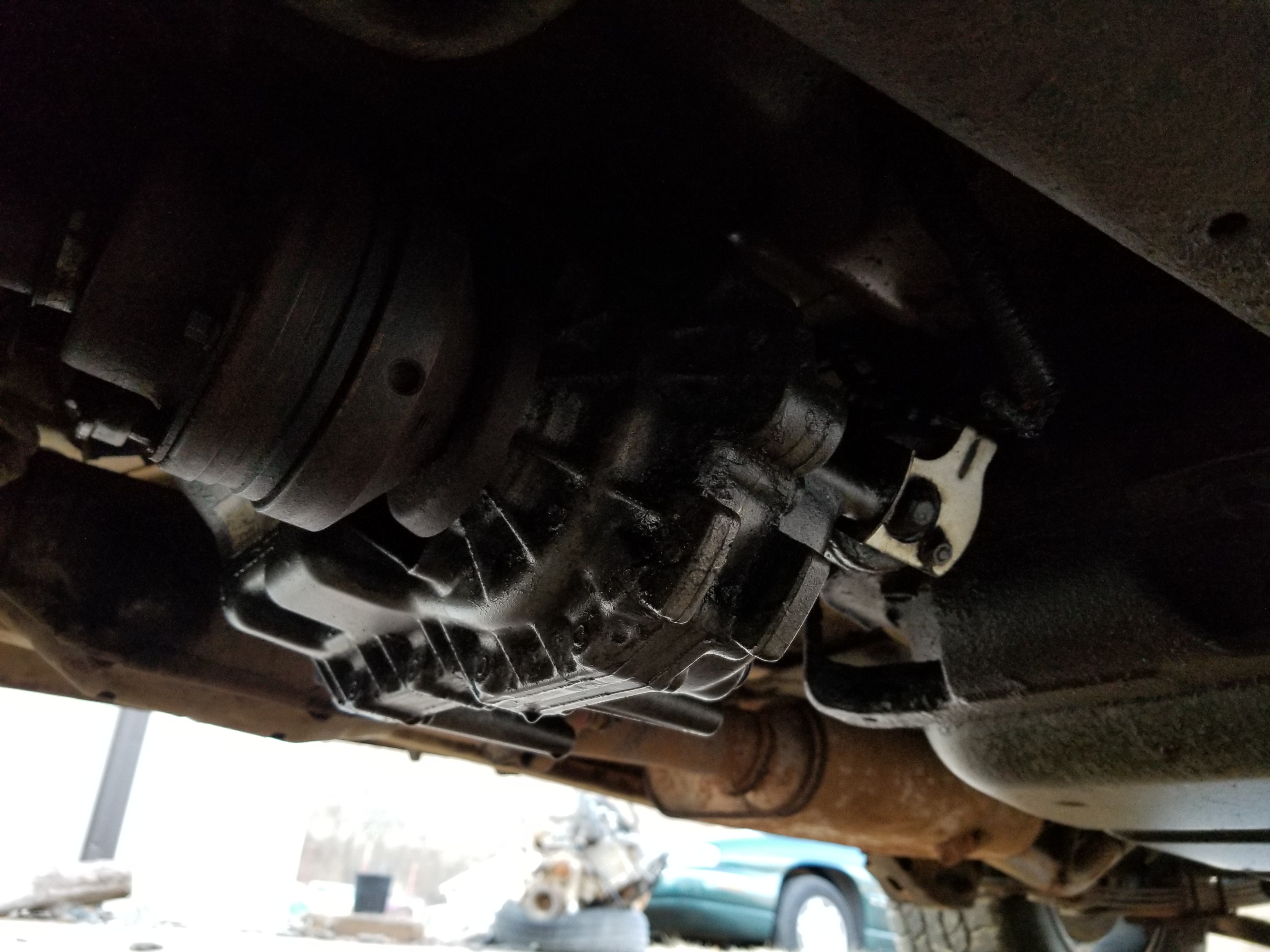

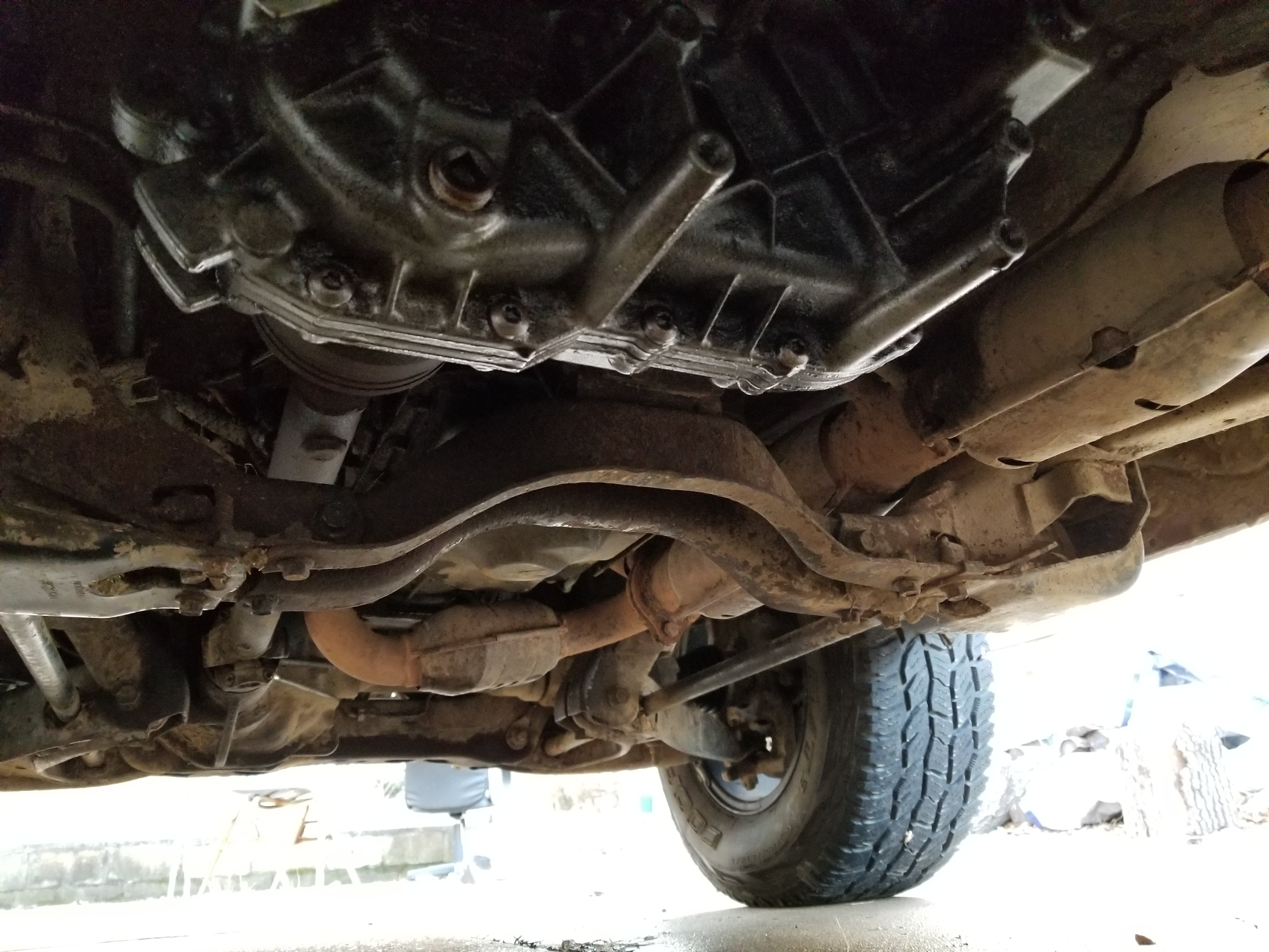

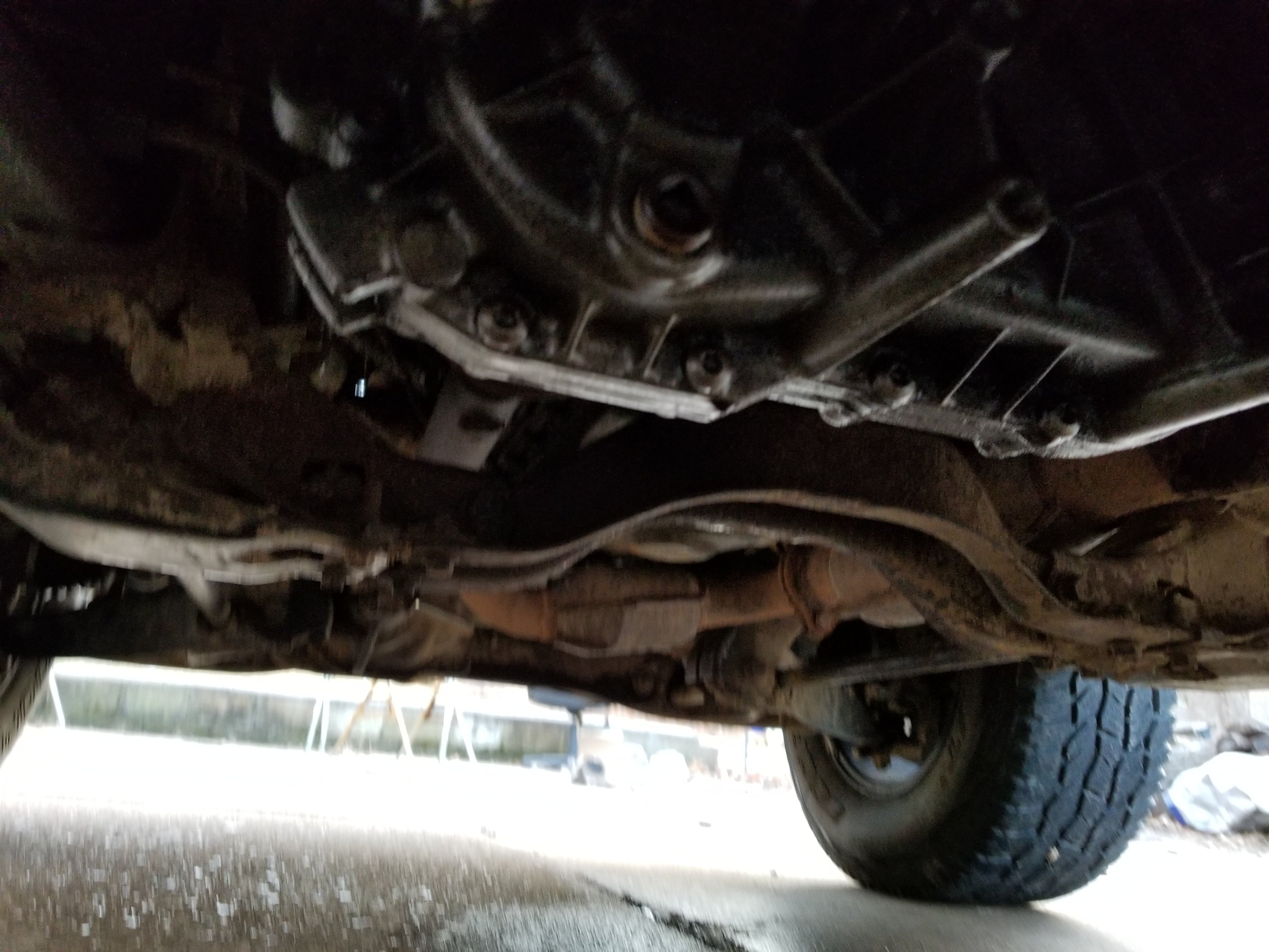

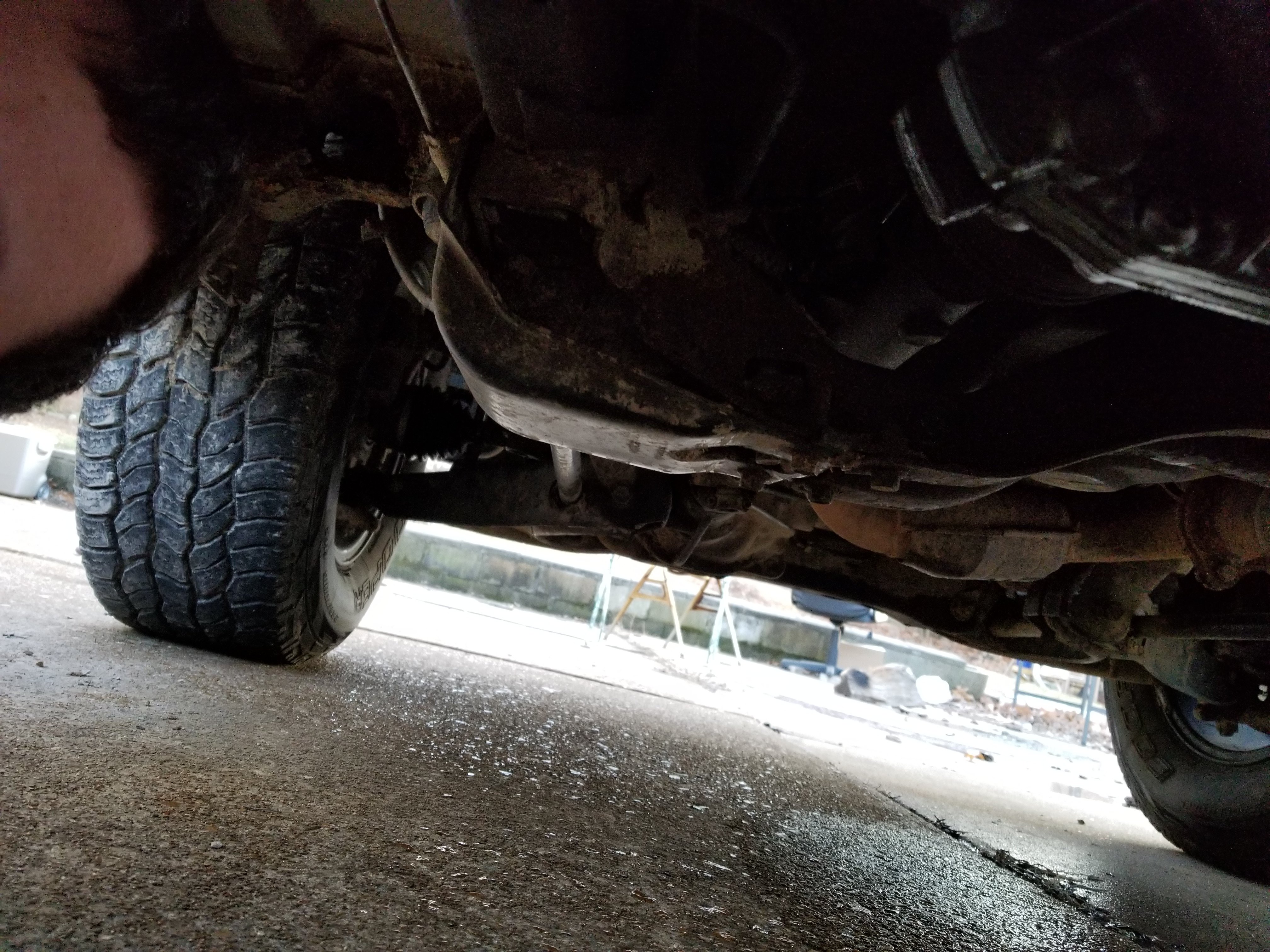

here is a pic of the transfer case. I talked to the shop who did the work and they had only replaced the fluid levels in it. They will no longer be doing work for me. So my recent information about the truck were wrong. The transfer case is original.
View attachment 154189 here is a pic of the transfer case. I talked to the shop who did the work and they had only replaced the fluid levels in it. They will no longer be doing work for me. So my recent information about the truck were wrong. The transfer case is original.

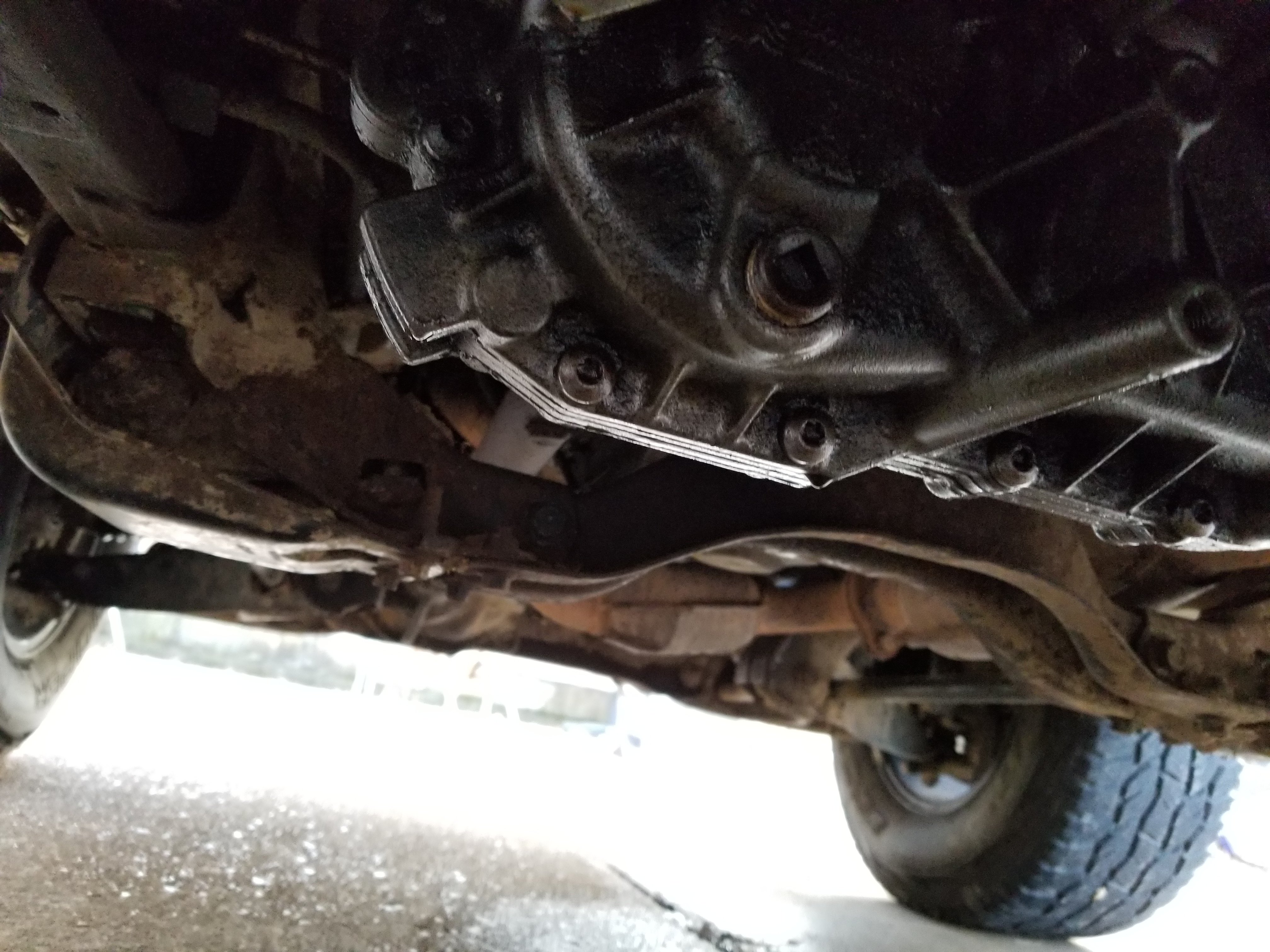

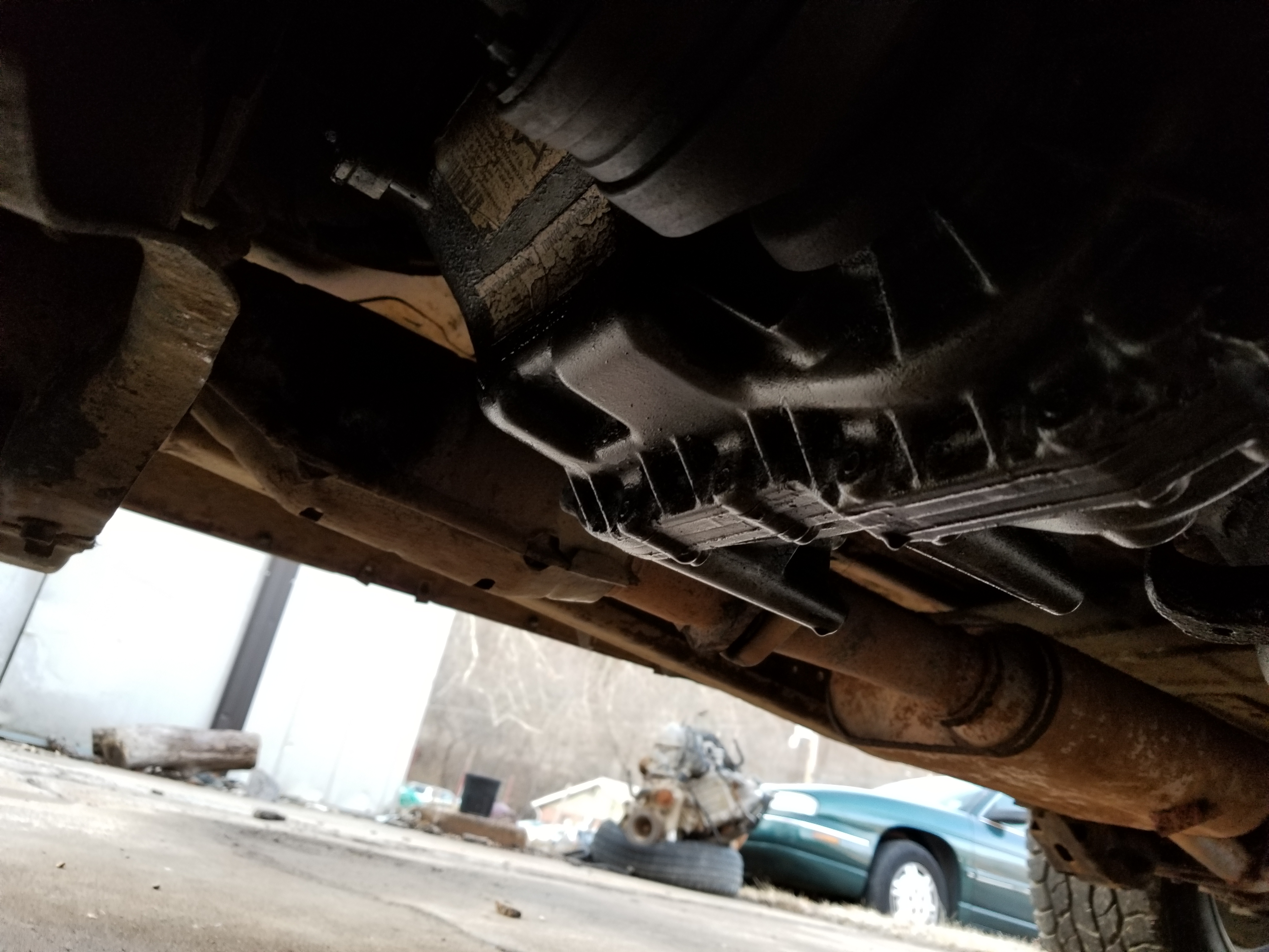

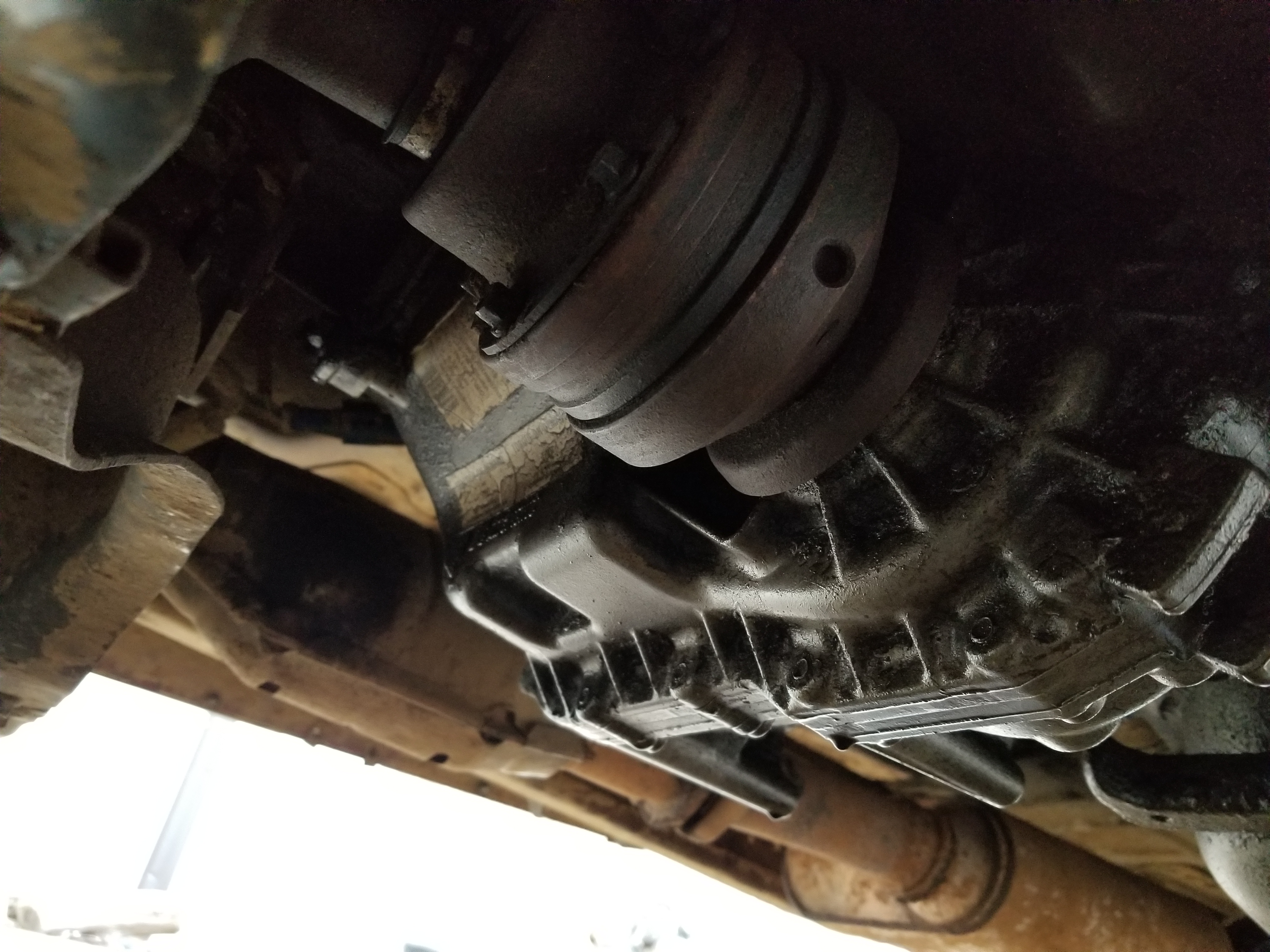

Here are some more pics from under the vehicle and the walk around view of it as well
