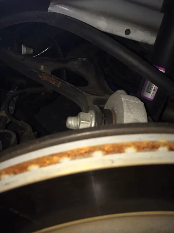

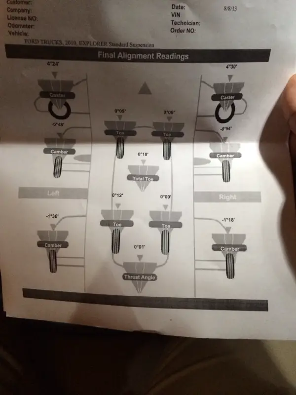

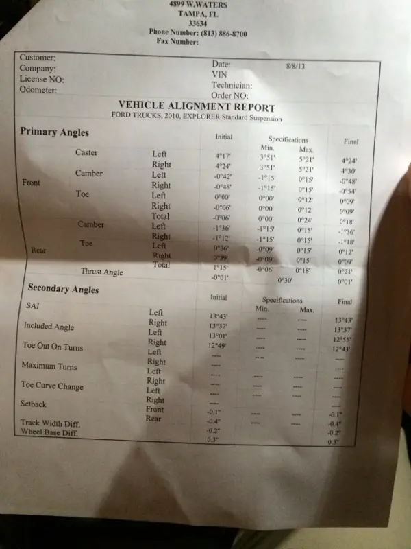

To anyone else who lowers it, I took it in for an alignment and the rear camber was way off at -2.5 degrees. They said there is no factory adjustment for it. After I got it home I found out there is. The hole in the upper arm where the bolt goes through for the knuckle is elongated to allow for adjustment. I put it all the way out and I'm taking it back to the shop tomorrow for fine tuning.
