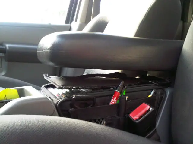

Bolt slides right out. Remove plastic end cap
broken bracket/new bracket
just a mock up.
I still have to do the padding and tuck the cover under the bracket(the new screws that came with the bracket are the silver ones. The plastic under the missing screw hole is broken also)
something like this. this is foam from some fruit that got mailed to me
this is also where the plastic has broken. under where you rest your elbow. what a mess
sorry for the rushed pics,wording, and workmanship...its 95 outside and I started this after I cleaned the blocked EGR valve on the wifes accord. I'm feeling a little dizzy and taking a break. I'll get back to it after a nap and some food:)
Got her all buttoned up! Thanks everyone! Yep, thats a screwdriver slip sratch.(from tucking in the cover under the bracket with an eyeglass driver) You can see the foam in the bottom. Ended up putting the foam ibetween the new bracket to lift the broken elbow area. The cover woulnt fit right with the extra foam on top of the bracket
Both screws are black and cover looks great(its just the sun coming in making it look this way)
Its nice and straight on top and bottom. Again the suns making it look weird
dont mind the stained pass seat. deer in road-gallon of milk smashed against glove box.(I will clean it some day) Its also the reason I have no flooring(but I like it with no flooring anyway)
