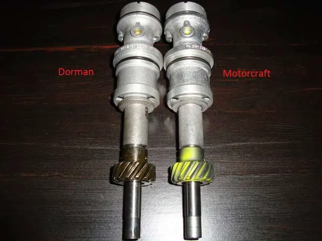

notice the thinner material used for rolling the pin on the dorman unit. This has been know to cause failure soon after replacement.

This regards the Dorman Cam Snychronizer Gear I just bought from Rock Auto. 98 Mountaineer, 5.0 AWD, 81k Miles. The Stator on the Cam Sny Gear crumbled, so I have just received the Dorman part. It came with a CPS and Installation Part. The CPS has only 2 prongs; whereas the factory part has 3, so I won't be using the Dorman CPS. The stator on the Dorman part is thin. I think the 98 stator is a semi circle. But since the one in the engine is cutoff, I cannot tell. Am I going to have problems with this Dorman Part? I did not want to buy a rebuilt part. Dorman is Chinese Factory fresh. Will this gear fit into a 98? Was there a change in design on the CPS to 2 prongs. Any info will help

Dorman part sent by Rock Auto was incorrect. I needed a 103 and was sent a 107 in a mismarked box. Rock paying return postage and will send proper part. Hence the confusion. Great help from the Dorman Tech Rep. The part number is on the metal ring just above the O ring.
Swapped out my cam sync gear with the Dorman part. So far so good, but I have driven the 98 Mountie little. Hope to be getting a digi camera soon and hope to do a write up on this procedure. First, could not have done it without this site. But, we really should construct a dictionary on the relevant parts, as they have been called several different names. The one possible problem I have, is the scribe mark I made on the top of the engine housing from the back of the bad cam snyc gear housing did not line up exactly..off by 1/16 of an inch. I suspect this had to do with the gear teeth of the new cam snyc gear, or the oil extension tube may be slightly twisted. Once I have more miles on this new part and there is no fall off in gas mileage, I will create the new post. Lastly, the removed part still squeaked when I rotated it. As a lark, I squirted some silicon in the area around the base of the stator/vane and let it work down overnight onto the shaft. Squeak gone. Perhaps there was a build up on the shaft under the base of the stator. This may be a bandaid for the chirp. This will only involve removing the 2 screws that hold the cam position sensor.
