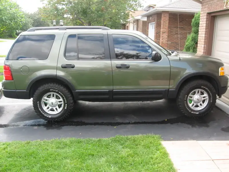

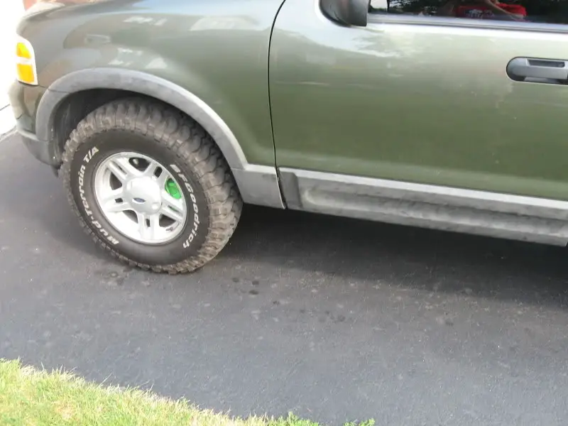

Here is my baby with her old grey plastic trim:

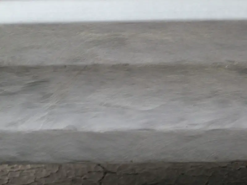

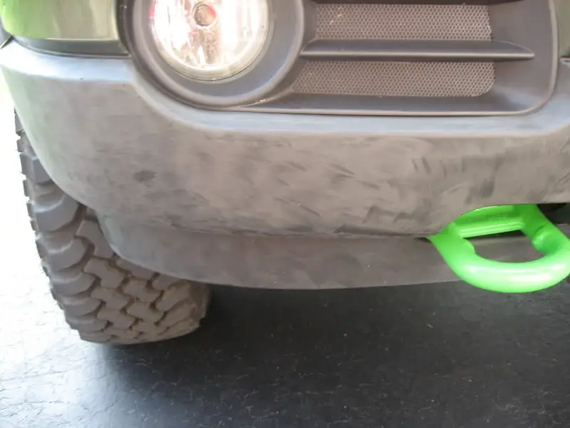

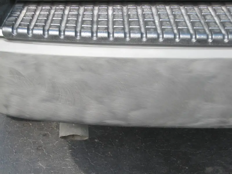

Here she is after about 4 hours of prep work. I used the scotch brite bad all along the hard to reach places and everywhere close to my green paint. The drill sanding attachment took care of the rest. I know prep work is 100% crucial to a good long lasting paint job... so I really scuffed the surface until there wasn't a hint of gloss on my trim anywhere! Once it was all sanded I painted on the acetone to prep the surface for the Herculiner coat.

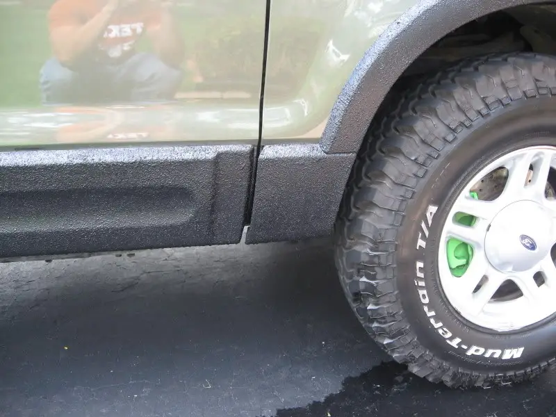

And here is the final product:
I am extremely pleased with the result... it far exceeded my expectations especially when it came to ease of use. It is a project that will take some time... especially prep-work but it is a great result. I definitely recommend Herculiner.

Nice work- one suggestion- while it's still clean, clearcoat over the herc- it turns grey and dirt sticks to it like crazy. I like the shiny black look myself.
It looks good though :thumbsup:
I used the Herculiner UV Topcoat Protectant.
