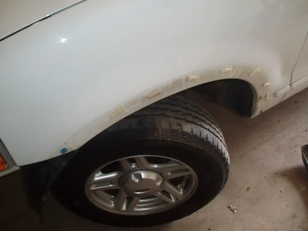

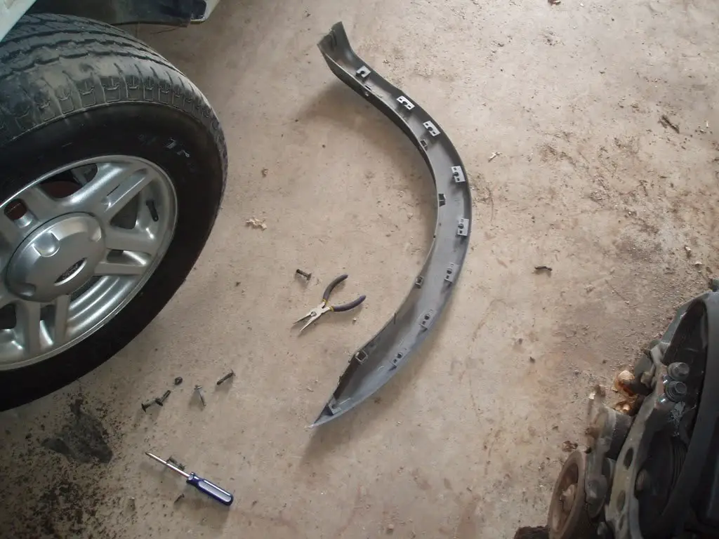

I've never heard of that... I had to replace a couple of little push clips... but that was not a big deal at all.
I found the fender flares very easy to remove. front bumper was a joke... rear bumper was about the longest process... but still easy.
Whichever way you wanna do it, but I truly did find it very simple to remove all the trim. :thumbsup:

Not sure on the door plastics as I have an xls, but these pics might help for the flares.
