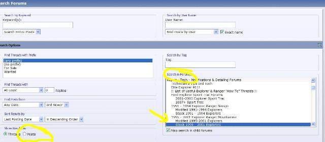

Hello good people and thanks for this great forum. As a new member who has been reading for hours around here trying to find some answers to my specific problem, one thing I have noticed- that trying to find problems/solutions for your specific engine type and year model is very frustrating. While you may find similar problems, either the year model or the engine type is slightly different.
So may I suggest maybe adding a forum that is sorted by specific engine type and year model so that users like me can go there and know that all related posts are concerning my specific year model and specific engine type? I really feel that would speed up this process tremendously.
If there is one, please point me to it! Otherwise, can a moderator please tell me the best place on this site to post the following information/problem?
