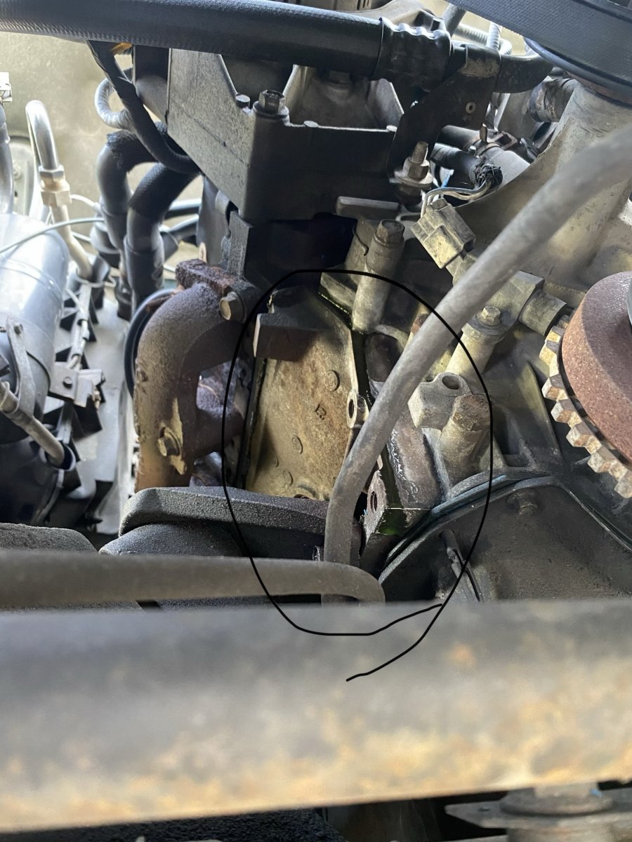

Hey guys, this page has been extremely helpful thanks to all of you. I’m really new to this DIY car stuff and this website has been a life saver. I have a 2000 ranger xlt 3L V6. I’ve recently come across a coolant leak under the bottom of the engine and I’m not sure where to start investigating. It doesn’t seem like the typical thermostat/hose issues I’ve run into before. Do any of you guys have a recommendation how to proceed from here? Thank you so much In advance!

follow the wetness up as high as possible to find the source.
You can also dry the area and then spray it with some Arid extra dry antiperspirant......then when the wetness returns the source will be clear
The coolant is coming along the side of the timing cover.......... but appears to be coming from up higher, perhaps from that upper hose/thermostat area

Looks like a classic FORD timing cover gasket leak, right at the match up point/hole with the water pump.
The gasket is between the front of the engine block and the rear of the timing cover assembly.
Here's my write up on the 4.0 OHV V6 timing cover gasket leak - you'll get the idea what to look for on your 3.0 Liter OHV
LINK: Removing timing cover on 4.0 OHV
Hope that helps!

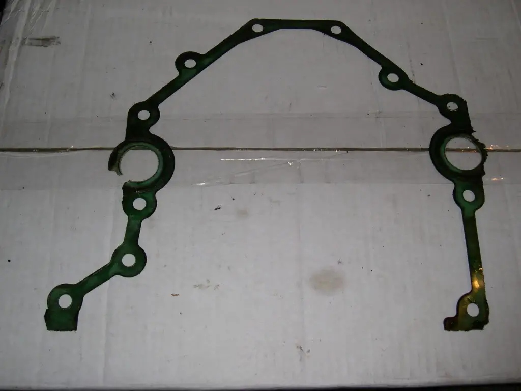

The thing is if the INNER part of the timing cover gasket wears where the water pump matches up you get water in your oil resulting in a catastrophic failure ala 5th Gen Explorer Cyclone V-6 Engines :cool:
Here's my 4.0 Gasket so you get the idea - this is worn on the outer edges
