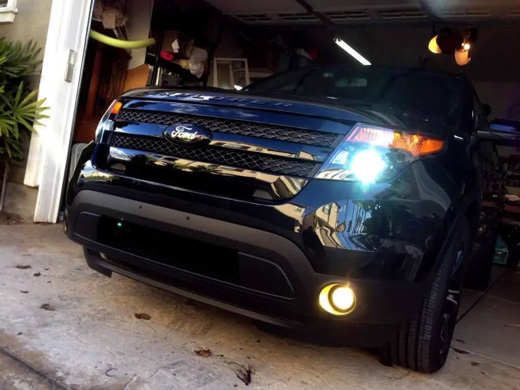

Ok, since no one else is responding, prob because of the holiday, Ill tell you what Ive experienced.
I picked two sets on Kensun HID kits on Amazon for about $50 each. 8000k for headlights and 3000k for fogs. Headlights are a bluish white, but not too blue in my opinion. Fogs are a real nice yellow. Headlights are 9005 and fogs are h11.
I have an issue with all 4 lighting at the same time with the lights set to auto. Since they all ignite at the same time. Each needing about 27,000v to ignite properly. The stock light system doesn't have the power to handle all 4. So there is a relay harness I am going to pick up for the fogs that taps the battery for power and givs the fogs what they need.
Other than that I am very happy with the kit so far (Although its only been 2 days). Easy to install and plug 'n' play.
I think the light output is outright amazing compared to the stock lights. I know some say to swap the projector housing as well, but I don't think this is needed at all. I think this is the best light output of any car I have owned... My other car is an e90 M3 and wife coming from an X5.
There are other brands like Morimoto Kits from TRS, which I guarantee is a better product and wont have any problems out of the box. They include the Relay harness I mentioned earlier. But their kit is $150 each and I just wasent spending that at this point.
