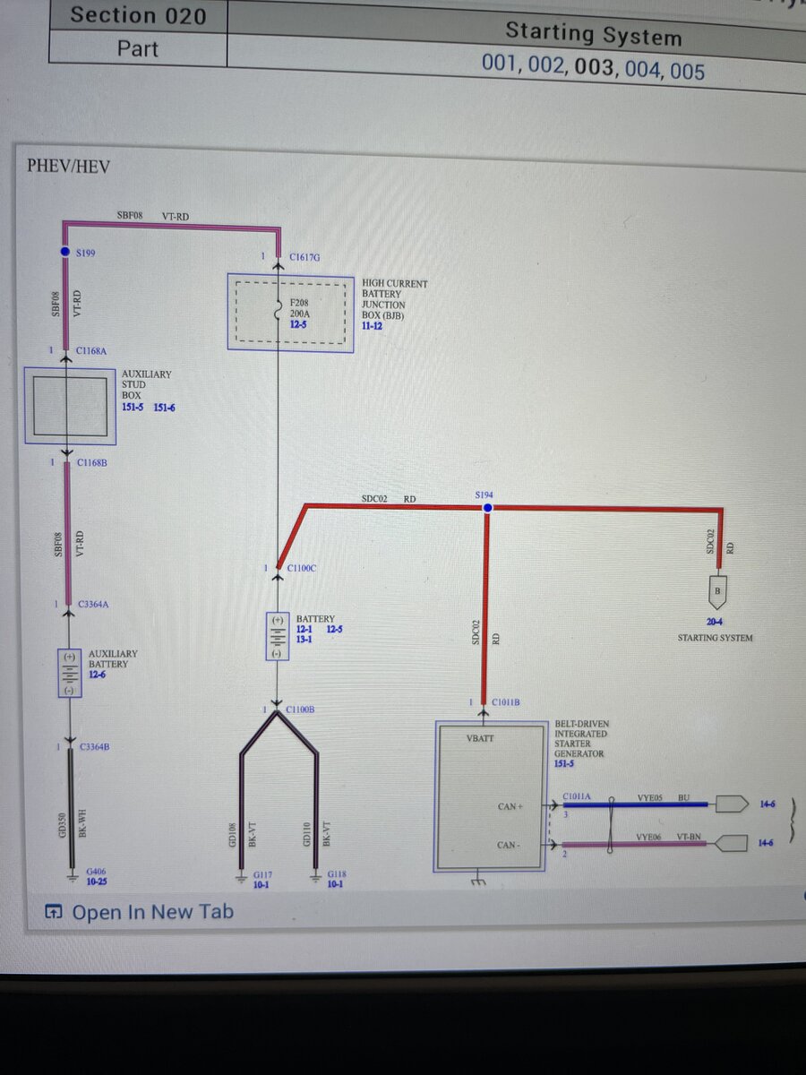

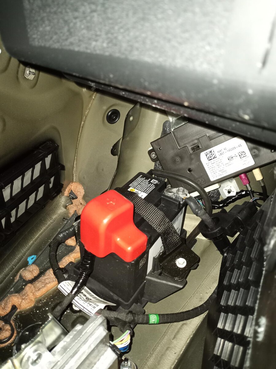

Working on 2021 Explorer Hybrid PIU, and found an extra battery. It is located on the LH side behind the lower interior panel, behind the LH wheel well. The part # appears to be AGM-AUX1-A. The only reference I found that even shows this battery is the "Explorer-Aviator ERG 04-22-2019 Emergency Response guide" pages 2-5, and 2-6. What I would like to know is what the purpose of this battery is. Their is already a battery under the hood, so why did they decided to put this small battery in the rear of the vehicle. Thanks in advance for any knowledge on this.
